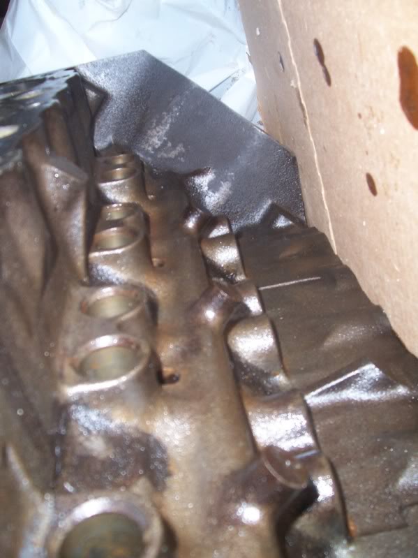

The only thing I'm having a hard time with is this... I'm having a hard time telling from pictures... but it appears that the surface the dog bones sit on is different for the roller vs non roller blocks.
This is my block:
This is a picture from the internets:
Im thinking this small difference will make the dogbones a bit unstable or not sit properly to begin with. Anyone have any thoughts on it?
This is my block:

Worst thing that can happen is, the lifters can drop into the bores at zero lift, far enough to disengage from the figure-8s. As long as that doesn't happen it's all good.
Yes it's probably a good idea to use the factory retainer plate, since your block has the provisions for it.

Non roller block has difference casting around lifter bores and is not machined flat on top

Well thats the thing, mine ISNT machined on the top surface of the lifter bores. Here's a closer shot...
Definitely different from the picture above with the machined dogbone surface.
