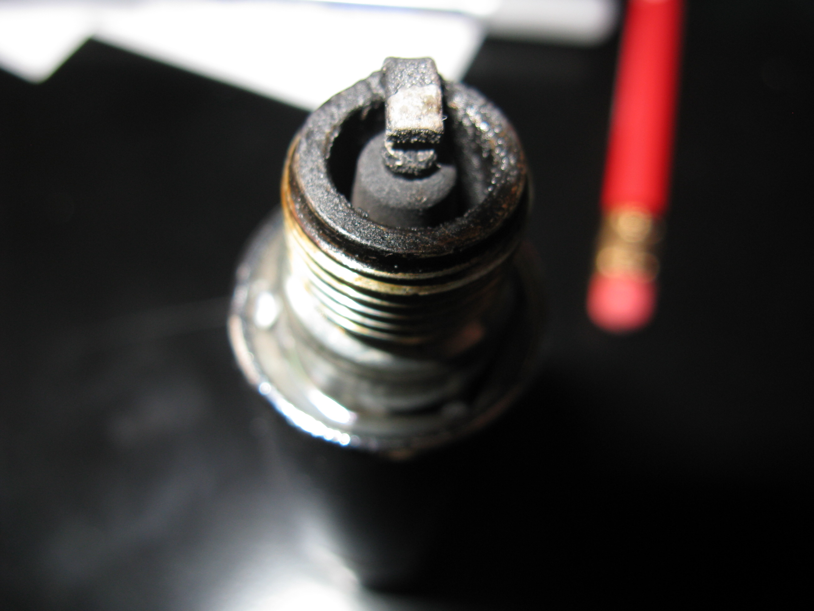

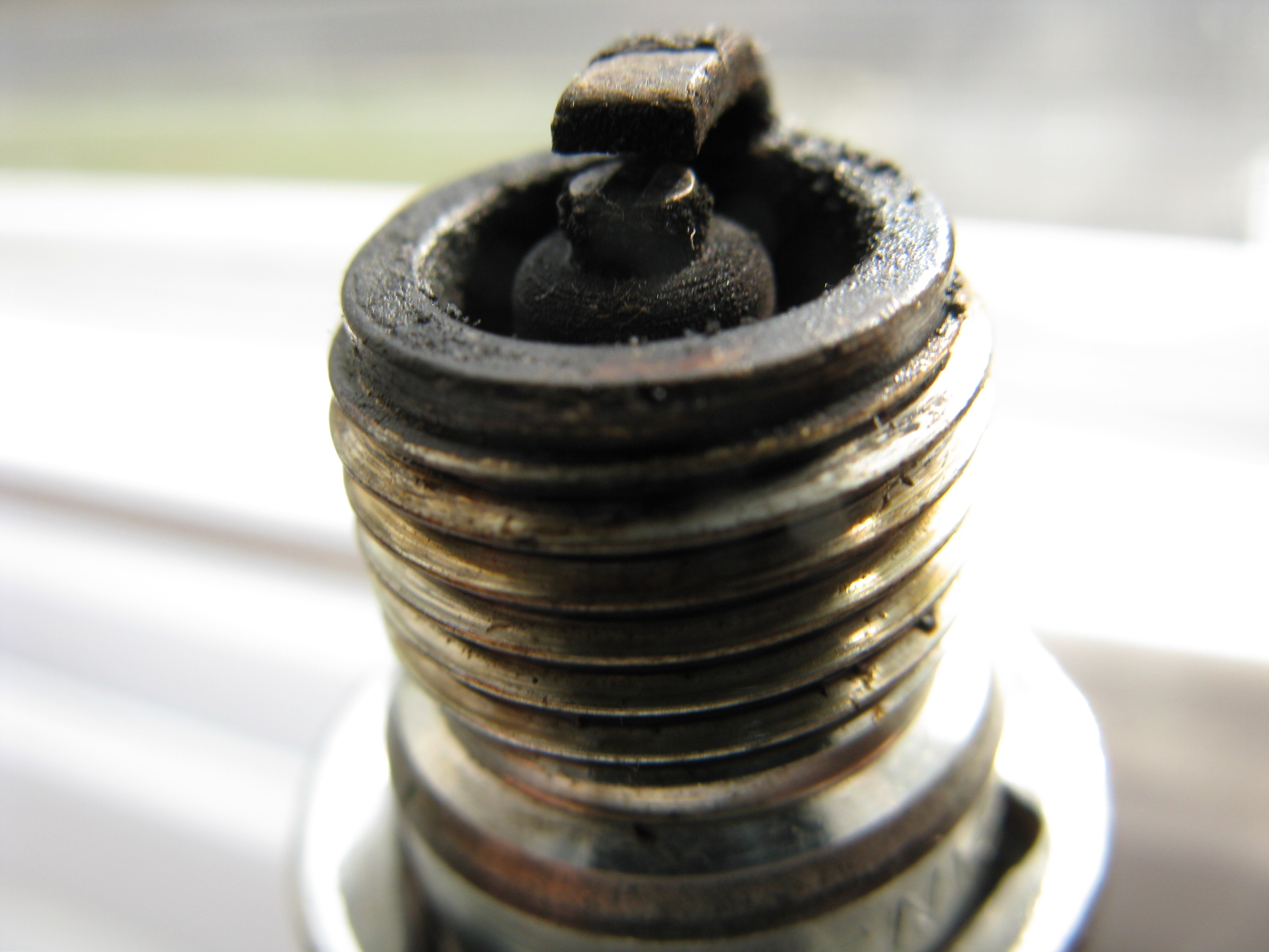

I did some further reading and it said low comprression engines with bigger cams like a lot of intial timing. I know the guy who built my engine recomended 38* Total for 87 Octane and 42* total for 93 octane. I also pulled my plugs and have attached pictures. Just a Rich mixture or is it a timing issue also? Plugs are NGK R5673-7 http://www.jegs.com/i/NGK+Spark+Plug...673-7/10002/-1
plugs recomended and installed by the builder.
