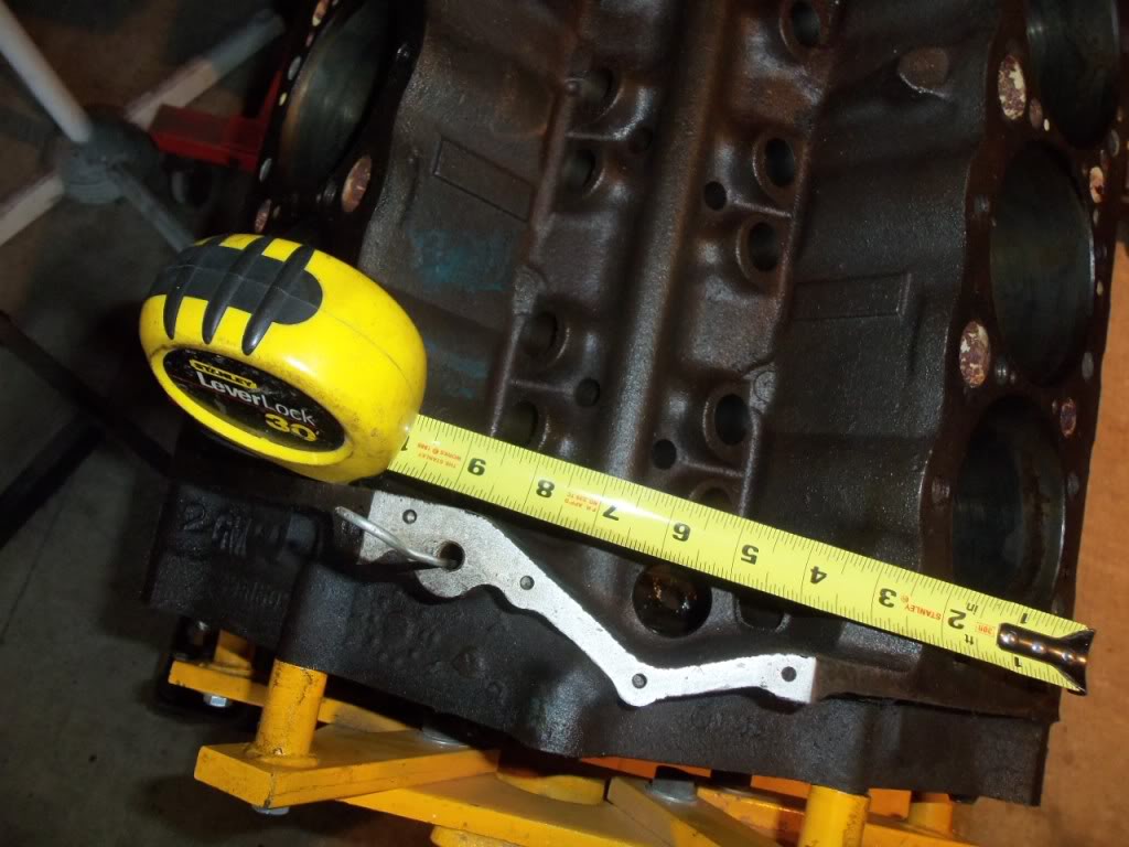

IF, you still have problems,...and your block was at a machine shop,...check to make sure they put the oil gallery plug back in at the back of your block. it should be roughly 8 1/4 to 8 1/2 inches down from the top of the block where the intake bolts on. use a piece of wire or a coathanger to check it. if they left that out, youll have all kinds of oil pressure issues.

im sorry, i pasted a pic for you but it left a personal link to the guys pic on it, so i took it down. ill try to get you a better pic if needed.
idk how much room you have, but you should be able to get in there.

Ah, Back of the block where I have my OPSU. Will check it out.
