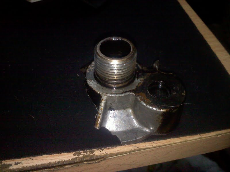

well i found the problem. turns out it wasn't the oil cooler gasket causing the problem at all. it was actually the the fitting that bolts directly to the block that was cracked. this was allowing way too much pressure reach the gasket that i thought was faulty.
