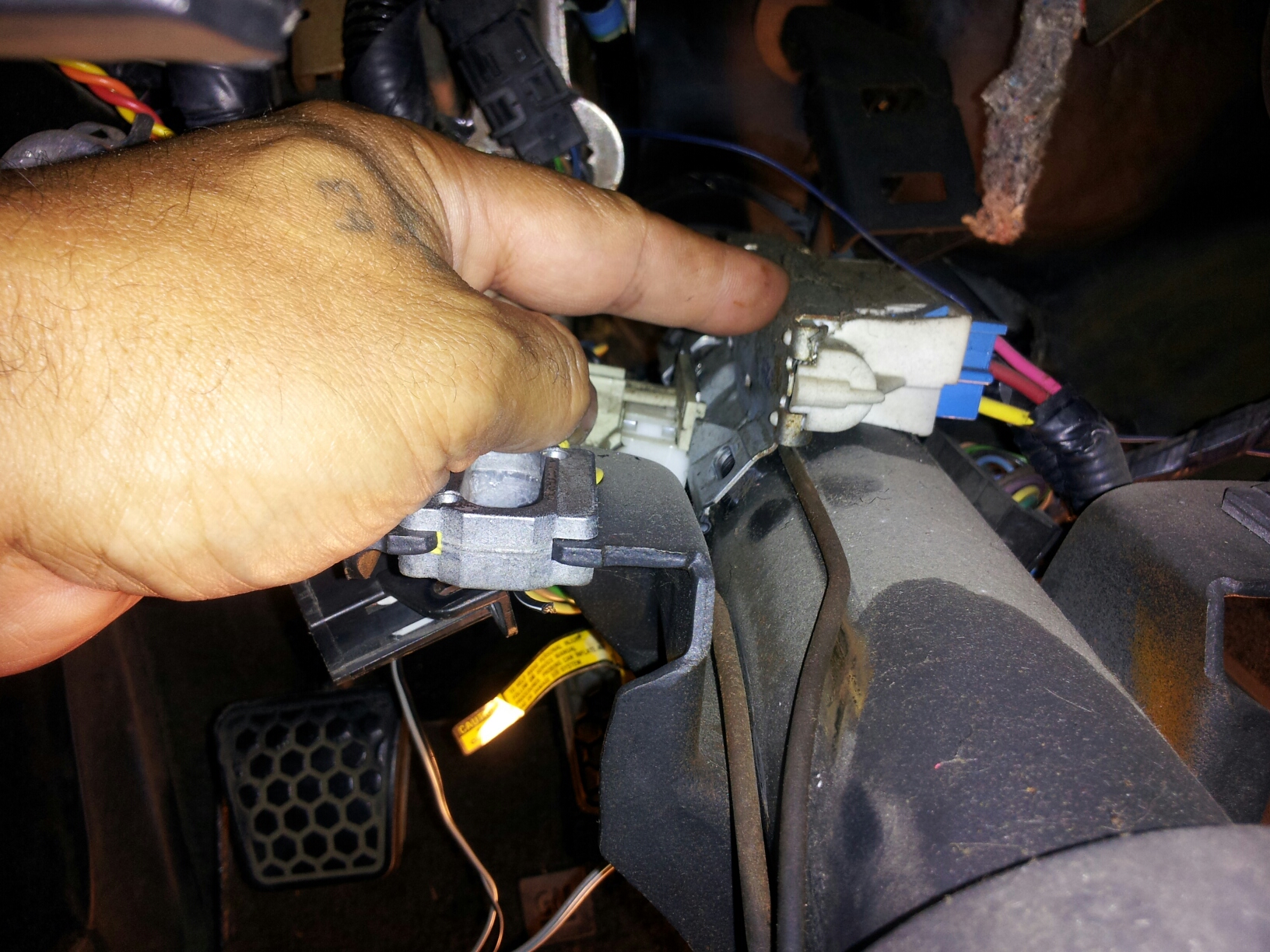

Well guys i did the test on the on the multi switch. I actualy took it apart cleaned it put back together and nothing. still clicking i also checked the ignition relay its working fine and before i forget i did test the thick yellow wire going to the mult switch and there is power going to it. I might go with push button start. im out of options

here are some pics
Attached Thumbnails car does not start when i turn the the key-20120724_114342.jpg   car does not start when i turn the the key-20120724_130001.jpg   car does not start when i turn the the key-20120724_130311.jpg
