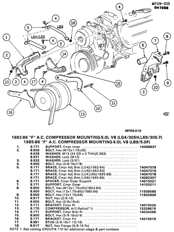

Re: how to remove this belt?? the smaller belt behind alt..
are you asking about your air pump belt ?
if so lay on the ground I think there is a threw pivot bolt and then a 9/16 or maybe 15mm tensioner bolt that need to get loosened.
sorry it looks like you air pump is gone so you mist be dealing with your a/c or power steering ?
3,5,and 7 for the power steering pump
thnx for the help, i losened the large bracket the holds the pwr steering pump and pully together and was able to remove the belt, however, after days of trying i tried the new belt and pepboys sold me the wrong one! oh well, it was a good learning experience...
