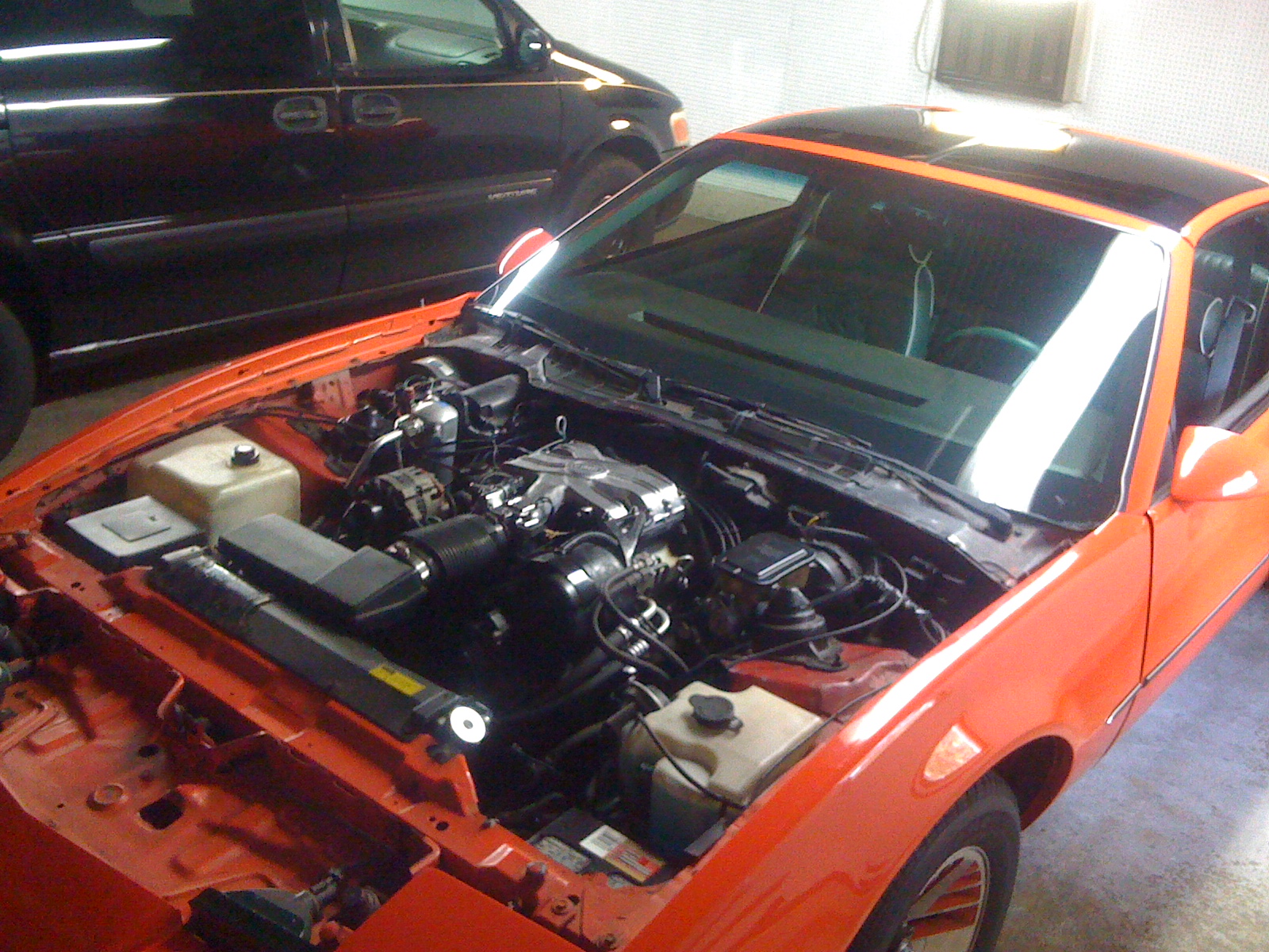

Some Six bangers got it on the driver's side too . Like my 89 bird here ...
Attached Thumbnails Configuration?-firebird99.jpg   Configuration?-firebird101.jpg
