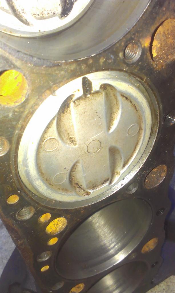

thanks ill look into those. I found out my pistons aren't really considered flat tops. here's what I have to work with
awe man, that sux.
id wait and get some flat tops,...and check the bores out.

By the way those are stock GM pistons. You can achieve about 9.4:1 maximum with those, 64cc heads and shims. After that you'd need to o-ring the block to get smaller shims and more compression or mill the heads.

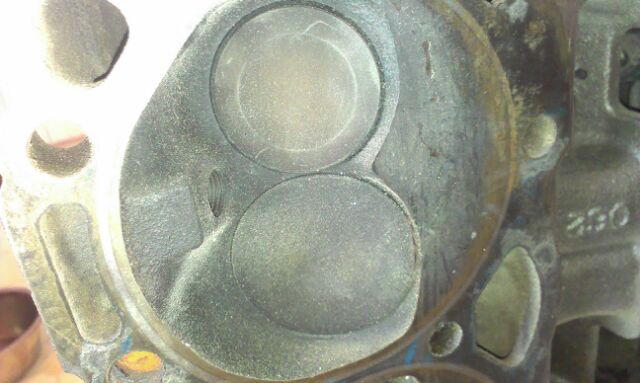

Got my heads yesterday.They were cut for bigger valves, and have manley screw in studs and guide plates. Unsure of springs but the heads went to the shop today to see what the max lift is and what the combustion chamber size it. Just want to make sure they were never shaved down. Also, pulled my lifters, dogbones, and the retainer from a totaled truck with 40k on it. Next I think will be pistons and figuring the compression ratio.
