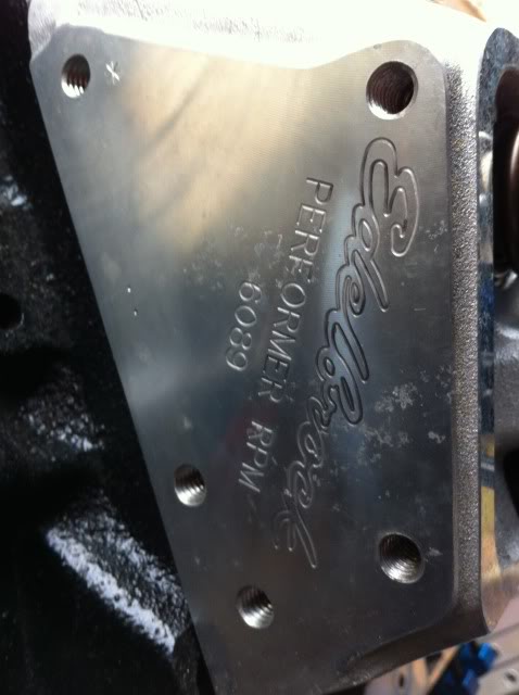

It had edlebrock Performer 6089 alluminium heads that have been ported by the looks.

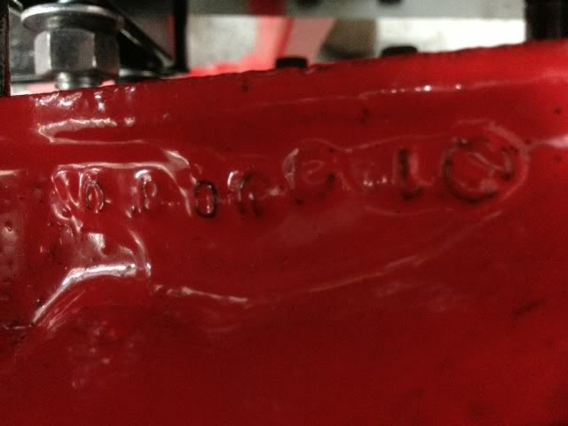

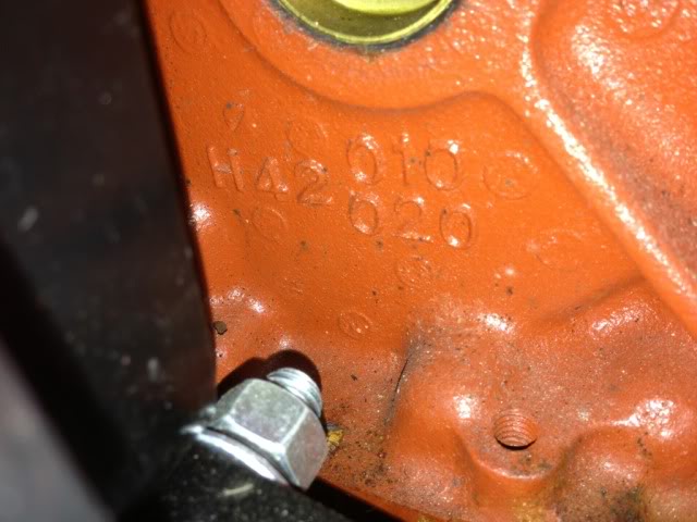

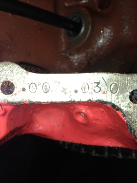

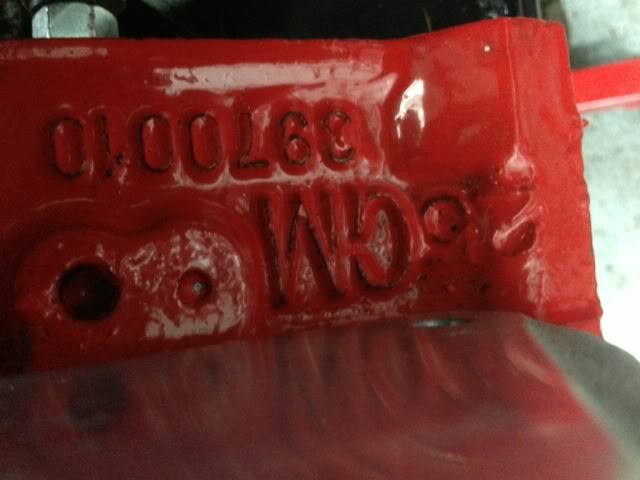

The only other markings I can find are these -
Any ideas what they are??????

If the crank has a casting/forging number, that'll tell its stroke.

The heads don't really look like they've been "ported". Just "gasket matched". That's mostly eye candy. Where porting MATTERS, is down in the bowl, aorund the valve seat; and around the valve guide. Can't be "sure" from the pics, but neither of those places looks like they've been touched.

Usually on the side of one of the rod throws... that being about the only place that no machining ever occurs to.
Just inspect the crank from end to end; turn it 90° and repeat; repeat and repeat; repeat until you're back where you started. Post up any numbers or other markings you find. Might not even be a GM crank, for all we know out here so far. Can't tell that in the pics one way or the other.

Looks like someone weighed the pistons and drilled them on the pads to get them within a specific range. Rods have what appear to be ARP bolts on then.
Someone did go through some not basic steps on it like the glyptal job on the valley and bellhousing side probably the same on the timing chain side.

Looks like the pinch area was taken down and there is some light bowl work just under the valve.

That's an lt-1 crank, seeing your casting number and the 010(1% tin) 020(2% nickel) yours could be an lt-1 block, do you have the suffix from the stamp pad???

That pilot bushing in the 2nd pic is in there way too deep, should be flush with the crank. It should go in tight, not loose. Need to drive it in.

Yup, that's a cast stock 305/350 crank; the familiar 442.
You can verify cast vs forged by looking at the parting line: a narrrow "sharp" line = cast; a wide (over 1cm) one that's been ground down = forged
They make both sizes of motor using that casting, but the balance is different.
