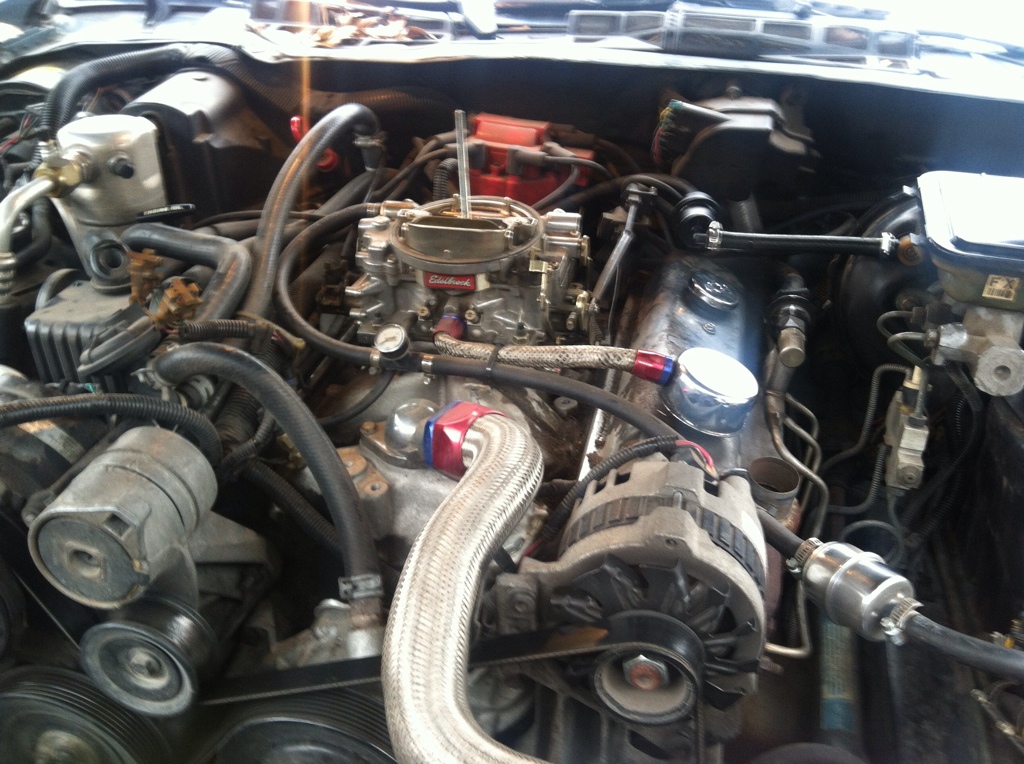

Alright so I'm getting ready to start removing the intake. I'm going to document it well with pics & video. So that if I make a mistake you guys can help get it done right. Heres a pic of how it looks right now, minus the air cleaner....
Quick question, should I drain all the oil from the pan & coolant from the radiator first?
Any tips/tricks are greatly appreciated this will be my first time tackling this.
Thanks

Thats what we found in the lifter vally, a crap load of water & coolant..... to confirm, this is caused by the faulty intake gasket right? Not a head gasket?
To remedy this we must first replace the intake gasket & then drain oil, let car reach operating temp, drain oil, run car about 1/2 hr to evaporate remaining water in oil.... Please confirm, & the distributor was a pain in the *** to take out, am I going to have issues with the timing now?
