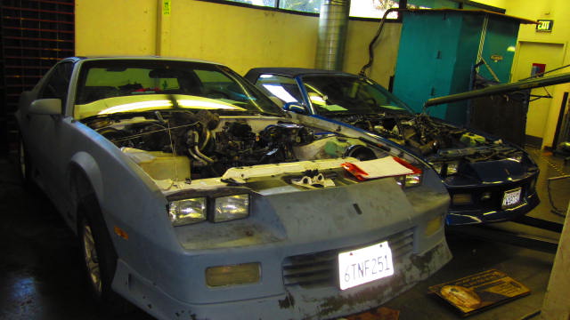

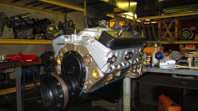

So I finally got the engine and transmission out together as of yesterday. Boy, was I happy, since this was the first time I've done this hehe . Also have a picture of a friend's z28.
EDIT: Mine is a mess compared to his lol
Attached Thumbnails Rebuild 350 or build 383-img_0333-1-.jpg   Rebuild 350 or build 383-camaro-mike...jpg

Sorry I haven't been updating, been real busy in my automotive class.
So I'm just about done with my engine and ready to throw it in next week. Come to find out my engine has been bored .030 over and it believe it was been rebuilt once before. I ported and polished the heads, got a double roller timings chain, and a 262/268 Lunati Cam shaft...I came across a little problem though. Well, this actually happened earlier when I first extracted the engine. So I was trying to detach the accessory brackets from the heads, but 2 were on so tight that I stripped the torx bolts. I managed to get them off with a pipe wrench, so that was good. anyways, could anyone help me out with the replacement torx bolts? or maybe a hex bolt that I could use in place of them? It would be much appreciated....and this is how my engine looks like now
