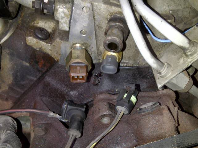

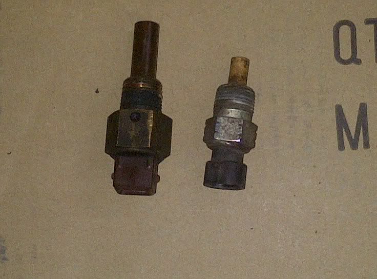

The one closest to the passenger side head is the cold star injector timer switch, the one under the bypass hose is the coolant temperature sensor.
the bypass hose on the throttle body?any chance you might have a pic man?

spoke to soon thanks for the pic hadnt seen it its definetly the one on the left

If it's the one on the left, the rectangular one with the reddish-brown plastic connector that runs your 9th injector (for added enrichment on cold starts). The oval-shaped one with the black/gray plastic is the CTS.

thanks guys it was the one for the 9th injector
