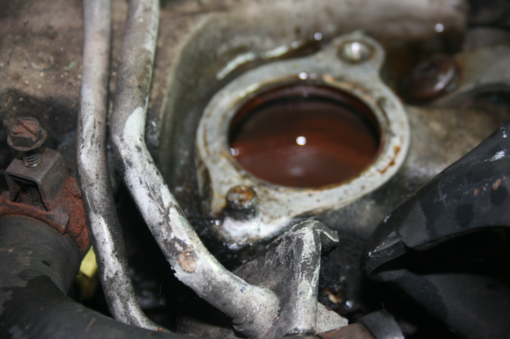

broken bolts
Any suggestions how to get bolt out without taken the intake off ?

That's an easy one, if you have access to a welder, weld a nut onto it, and loosen it off, it may take a few times, but it will come off. or get a bolt extractor, they make them that will fit over the stud and turn it out. Shouldn't have a problem

I hate to bring the ants to your picnic but there isn't enough of the bolt left for any of the stud extractors I have, and I have them all. The welder is your only real hope of extracting that bolt. Or you can get out your drill and try your best to drill it out. I do them all here, even the ones I don't break. I have pretty solid success using cobalt bits, including left handed drills that will sometimes spin the bolt out. The trouble in your case is that the bolt is probably corroded to the aluminum and isn't going to want to break loose. That's where the welding trick is good because it heats up the bolt and helps break it loose. A torch also works when you have something to grab onto. What I suspect will happen if you use a stud extracter on what's left of that bolt is you will spin off the end of it and then end up having to cut it back down flat so that you can get centered on it to drill it. One thing you can't use enough of on old rusty stuff is PB Blaster, or any other good penetrating oil.

I've removed allot of broken bolts, that one is likely seized, heat it, real hot and let it cool, or heat around it, the nut trick would be ideal, but if it isn't an option I'd certainly try one of these http://www.irwin.com/tools/screw-bol...olt-extractors I've seen them at AZ, Advance, and Napa, I have the same thing Matco or Mac branded. It might work, you're not out much if it doesn't, only then would I l.h. drill since it also may work, and then use a e-z out or other spline type extractor, I have most if not all, and prefer this type

Grind or file the top of the stud flat. Center punch EXACTLY in the center, real deep. Drill into it with a small bit (1/8" or so to start), then progressively larger ones. With luck it should give up the fight at about 5/16".
Heli-coil the threads, which are almost certainly destroyed, just like everybody else's. Use stainless steel bolts when you put it back together.
