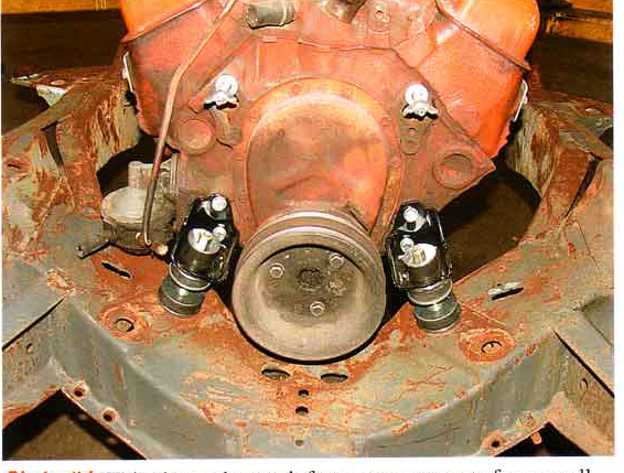

It's very strange that a block WOULDN'T have those holes drilled out... those AREN'T specific to serpentine bracket systems, after all. They were the ORIGINAL motor mount location, up through the 50s, before they added the pads on the side of the block that our cars use.
From Real Deal Steel...
Hard to imagine a block not having those. In later cars they were the mounts for power steering pump brackets, mostly. Butt hay... I'm not going to call anybody a liar, if they say they had to drill & tap their block, then they know better than I do what state their block was in. I've seen FAR WORSE machining mistakes made on those old crappy 70s blocks, which is why in 2020, I will NEVER build a motor out of one again.
