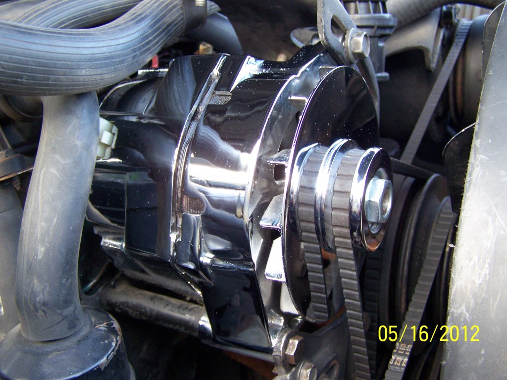

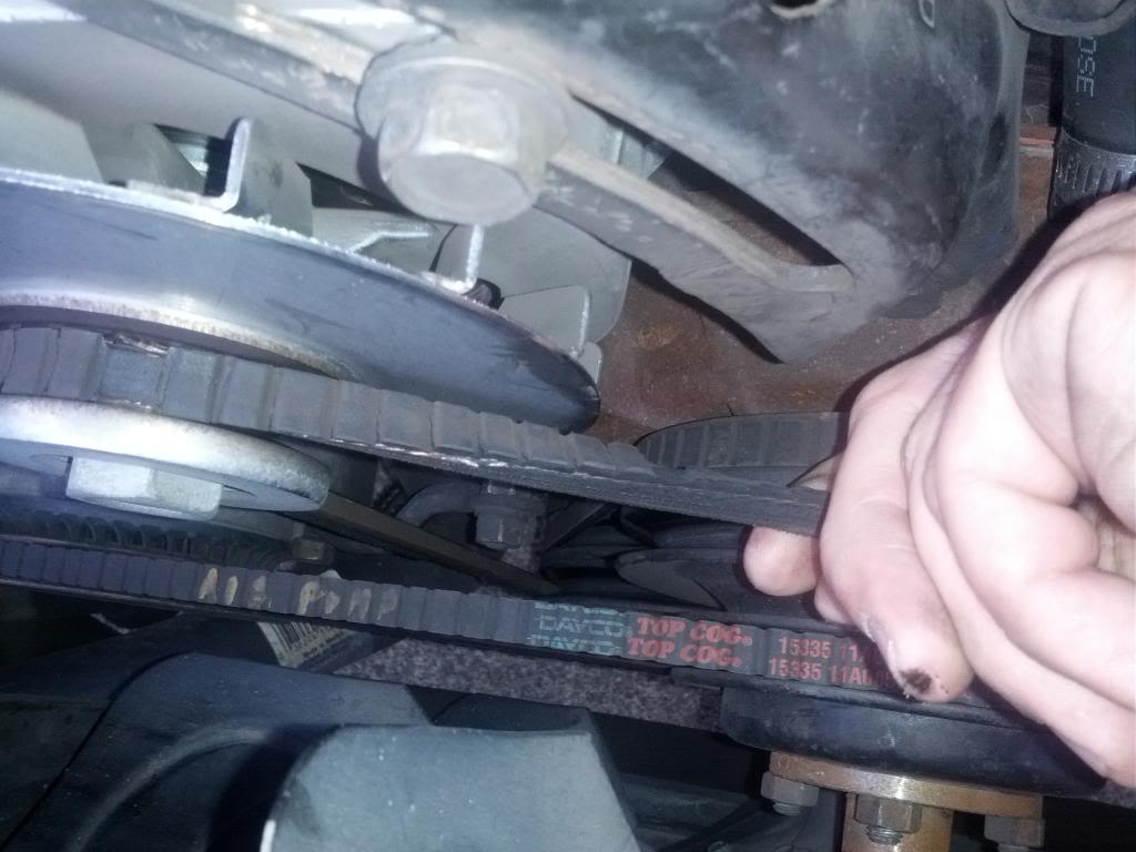

Included are some pictures of the alternator taken 06/25/2013. All the belts visible in the pictures were installed at the same time, however, only the alternator belt is in need of replacement. The alternator was installed complete with the Powermaster pulley wheel. The brackets are factory - only the alternator itself is aftermarket. The belt is still very tight and snug with very little play or deflection despite the condition it is in. I am not sure if the belt is simply running warmer than the others or is rubbing the pulleys the wrong way. Have a look and share your advice. Thank you - Nathan.

Looks to me like a couple of issues going on.
In photos 3 and 6, the alternator pulley and the water pump pulley appear mis-aligned.
The belts running in the water pump pulley all look alike, as if the belts are too wide for the pulley groove (note the dished appearance of the belt). I would discount this for now because if this was an issue, I would think all the belts would be showing some distress.
Because the issue is with the alternator belt, I think there's something up with the alternator pulley and/or its alignment.
If you have a stock alternator, I'd install that and a new belt (Dayco) and check your belt life.
I'd also loosen the belts and re-adjust them. Little or no deflection is way too tight, IMO. I adjust belts with about a 1/2" deflection up and down (1" total) deflection with modest pressure at the longest run between pulleys.
I recall an online Gates belt failure troubleshooting guide. You might want to try a Google search and see if your problem is addressed there.
Edit: Are you tightening ALL the alternator adjusting bolts? Leaving the bolt that the alternator "swings" on loose can cause the mis-alignment seen in your photos. Also, over-tightening the belt can force the alternator to "tweak" causing mis-alignment as well (in my experience).

The pulleys are not lined up. The alternator is too far ahead. Check the air pump also, it does not look straight (but it's close). The a/c side does look pretty good. And what is that groove in pulley on the alternator? (The engine side) Mine have always been smooth. That might be where you are tearing up the belt.
