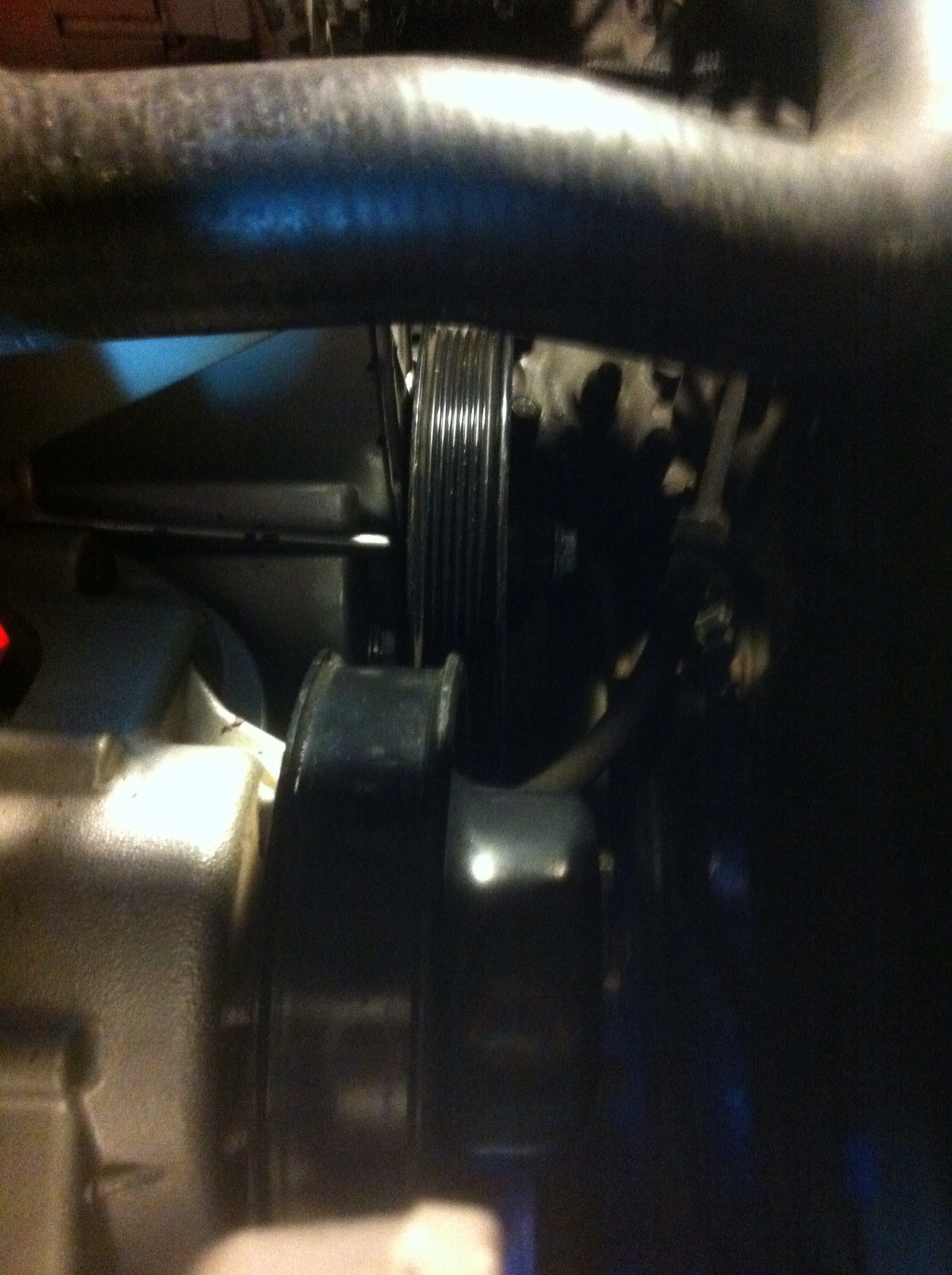

I did the serp setup on my 87 305 tpi camaro. Now that everything is on I went o put the belt on today and noticed the water pump pully is towards the motor about 1/2 in closer than the rest. I bought the whose kit from a guy that had it set up on his car so I figured everything was correct. Are there different pullies for the water pump? Here is a pic of how far it is off. The part number on the pulley is 14102093NH.

You may have a differnt water pump than he had. There is a short one and a long one, although Im not sure if our cars got both varieties. But I do know the belt systems changed over the run and Im not sure if all the water pumps rotate the same direction either, so it might be a good idea to go ahead and grab a new waterpump for whatever year car the serp belt is from.

^^^What he said, the kit is probably for a long water pump^^^

The serpentine system turns the WP the opposite direction from a V-belt system, and therefore the V-belt pump won't work with a serpentine "kit" and must be changed, regardless.
Easy way to tell which way a thing rotates: if the inside (ribbed surface) of the belt goes around its pulley, it turns the same way as the crank, clockwise; if the outside surface (the back, the smooth side) goes over it, it turns the other way, counter-clockwise.
There is no such thing as a short pump for the serpentine system AFAIK, since the short pump was last used in about 1973 and the serpentine ("snake-like") system was introduced in about 1987.
Get the right pump and see if it cures itself.

Serpentine belt set ups use a different water pump then v-belt systems. It is a reverse rotation pump as it is spun in the opposite direction. Need to get a different water pump.

There is also a truck serp setup that uses a different depth pulley setup than the 3rdgen and caprice.

What year water pump should I use? I'll go to auto zone today and pick up a lifetime water pump and see if that fixes the problem.

88 - 92
Measure how far the pulley flange is from the front of the block on your current one and compare to the correct one.
If you discover that the correct pump is the same height as what you've got, i.e. the pulley depth is wrong (which wouldn't be much of a surprise), stop at yer local buzzard nest on yer way back home and pick up a pulley. Go ahead and buy the pump because you ABSOLUTELY MUST have that anyway, but be prepared that the pulley may still be wrong.

It's funny cause I bought a used pump from a guy that had a serp setup on his that was a 90 and its the same pump at the one that came with my setup. I really think its the wrong pulley. Either way ill stop at auto zone and see what there pump measures. Thanks for the help guys!

Ok update! I bought a brand new from napa reverse rotation water pump and its the same fitment. So now I need to find a new pulley. Does anyone sell them new? Napa didn't carry them. My local scrap yards say they don't have any. I find this hard to believe. So this is where I'm at now....

I'm thinking the TBI caprice, roadmaster also use the same water pump pulley

Thanks everyone. I found one locally. Also found camaro specialties in my search that just happens to be a couple miles down the road from me. So now I have everything replaced and the belt on. Serp setup is now complete
