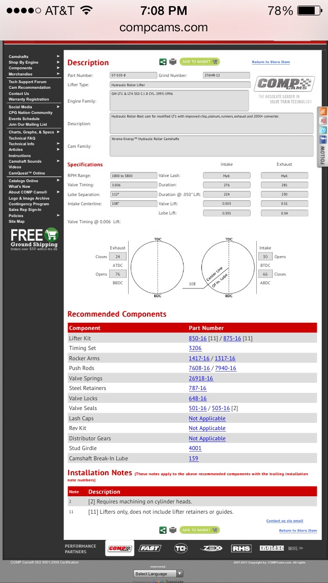

I want to know what size injectors I should get for my new setup. Im building and dropping an lt1 in my 88 iroc, it's a distributor lt1 from a 97 silverado. I'm doing headers, exhaust, flat top pistons, porting and polishing heads and intake, and ram air. I will also be using a comp cam, the specs I will include in a picture, any input is greatly appreciated! Thanks!

Instead of taking pictures of cam specs, just tell us what the part # is.

No, don't know the number, I have a chem test today and a engineering graphics presentation tomorrow so I haven't looked haha, but I've got the 906 vortec heads, and I'm getting an ss/z28 intake and throttle body, I bought the motor as a used long block. I'm just using stock replacement federal mogul pistons. But it's a 2 bolt main 97 350, I have a pair of swap meet vortec heads haha, I believe the 906 are the 1.94 heads, and I have the 19lb stock injectors from my lb9, but I need new ones I'm assuming and just wanted to know what size y'all thought. Fell to 10.94 head gasket raises me to 10.8:1 I believe plus porting and polishing the heads and intake, as well as headers, exhaust, ram air, and so on.

1.94" is pure raw unadulterated BS. That's the stock 350 valve size. Doesn't describe THE HEADS at all. Leave that out.
