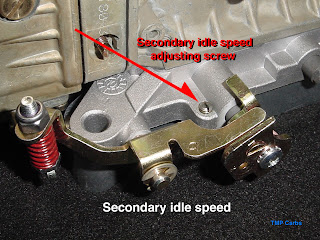

The hesitation is probably a combination of the street avenger carb (they are know for this issue) and the timing.
Put the light springs or 1 light and one med spring in the distributor then set the timing to 36 at 3000. Make sure the timing is correct before you even touch the carb. I would even sugest double checking tdc with a piston stop as inexpensive balancers have a tendency to be off by quite a bit.
Next take the carb off and set the idle screw so the primary transition slots looks like this
Idle_transition_slots_setting_zps7bcc767a.jpg?t=1378700924
next turn the secondary blade stop screw upside down like this so you can access it from the top and use this screw to adjust idle speed. Sometimes its a little loose in the threads when turned upside down. Try a little threadlock or silicone to hold it.
Put the carb back on and adjust the a/f screws and use the secondary stop to adjust the idle speed.
Should run like a different car, but you will probably still have a bog from the street avenger carb
