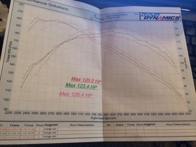

Hey guys, I finally took the 84 in to get a dyno (5.7- 350 - TDL Suffix). To say the least ive been quite discouraged today.
The numbers...
So anyways I have a limited mechanical knowledge but I know I want more power, so I decided to take it to a local performance shop, get the dyno, and ask the tech about what options I had.
Basically, he tried to tell me he could do a LS swap with all the goodies making 400+ for 6k, or a 383 stroker making 450+ with all the goodies for 8k.
The problem is, I was hoping (dont we all...) to spend more like 2-3 k and make 300+.
I'm not trying to drag this thing, I mostly want a little street monster with some speed light to light, smoke some civics and have a few extra smiles per day.
I planned on doing the interior myself (experience) body is already good to go.
With all that being said, I dont know if he was just trying to up sell me big time or...
Is there not a way to get this thing to 300+ with bolt ons or at least a smaller price tag?

i thought torque and horsepower always crossed at 5252? seems like they didnt even push the motor that hard? then again i could be totaly reading that wrong?

You better be making a hell of a lot more power than that for 8K, LOL. Someone's got greedy pockets.

I would say those numbers look pretty good for a 20 year old engine that wasn't exactly a performer when new
Problem is before you go doubling the Hp of your engine with bolt-ons
you need to determine what it's actually cond is .
While it may be happy at 150Hp , 300 may not be so kind to worn out ,20 YO parts
and a rod through the block has habit of blowing any budget" considerations

Crank or RWHP ?

Why are you disappointed?
What did you expect a 150HP engine to make on the dyno?

If you look at the graph, the lines for torque and hp look like they ARE going to meet at 5252...as the power falls down
Re: Just got dyno numbers... Feeling discouaged :( ...options?
The problem is the engine dude and your are lucky you're only losing about 30-20 HP through the driveshaft and differential. If you aren't bothered by using truck engines go look for a 1996+ Chevy or GMC 5.7L they came with 255 HP.

Okay, part of the "problem" is the Dyno Dynamics dyno. They are known to read low. Probably the lowest reading dyno out there. Likewise a DynoJet is usually the highest reading dyno. So if you want to feel better find someone with a DynoJet.

Jmo pull the heads off and see what you have. I would bet deep dish pistons. I would also bet on a tiny cam like the peanut cam considering the peak hp is at a super low rpm. If you were to keep this engine i would do:
-long tube headers 1 5/8 primaries
-ditch the emissions gear
-some kind of cam.
-vortec heads plausibly with some milling and an rpm intake or something like that. Will increase flow and bump compression. Check your head casting numbers if they are 72 or 76cc you have some improvement to be made there.
Do you have any idea of afrs or timing? All that can throw a big wrench in things.
Ed:the track will be the truest metric of your power. The mph is probably a more reliable indicator than a dyno overall

If 300 will barely leave you content why bother?
LS1 Camaro or do the swap. Those motors rarely break, can take a beating dont leak and respond big time to simple mods. If you like the Gen 1 a 383 top to bottom isnt bad installed for 8k. Spent more than that in parts for mine.
Head and cam swaps rarely get us the results that we hope for usually comes in the form of a larger motor altogether. Sell her off save and get a clean LSx car Id say youll be happier in the long run.
I would not spend any money on a used motor I dont believe anyone. As Vortex said most "strokers" out there ARENT, most are lying and some think a bored 350 is a stroker. If they were so good they wouldnt be selling them. Just got a call from a bud who was raving about a 502 BBC he scored off craigslist, turns out its a low compression 496 truck motor with a nice intake....and the #s ground off it. $3500 poorer and pissed.
Btw check out the goodwrench quest. It is probably similar to what you are starting with.
Posts: 482
From: Michigan!
Engine: Vortec 4200 Inline 6 PT70 Turbo..
Transmission: 4L65E
Since you are already carburated...
Do a LS truck engine. 4.8/5.3/6.0.... The wiring aspects are eazy since you ditched EFI... The EFI and wiring is the hardest part of a modern engine swap. 5.3 truck engines are worth their weight in scrap and usually come with a 30 or 90 day warranty..
