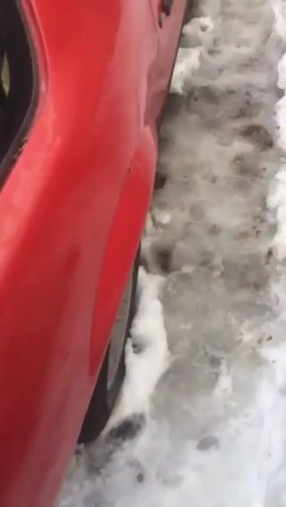

Well I got it running today. I dumped a can of B-12 into the tank and 2 gallons of fresh 93, poured a little down the primaries and it fired right up. Didn't drive it because of a new problem... there was what looked like transmission fluid pouring out from where the driveshaft goes in as you can kind of see in the video. When I reached down later and got some on my fingers it seemed like oil and sure enough i'm about half way down on the dipstick. This is a fresh engine installed last fall with about 125 miles on it by the way. Also have an exhaust leak between the header and y pipe but i'm not very worried about that right now

Having at least a driveshaft yoke installed is necessary to keep the oil in, but I'm sure you remembered that as soon as the puddle appeared.

Sorry I should have said that differently, the driveshaft is in and connected. It's almost as if the yoke seal is bad.
