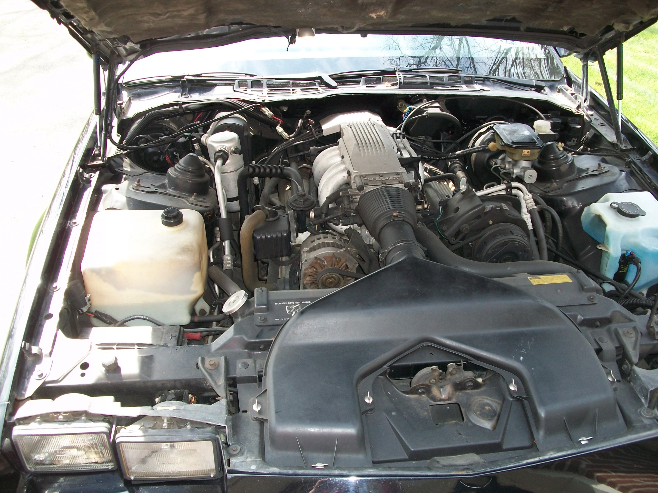

Hello folks. I'm sort of new here and I am working on my dad's 1989 IROC Z with the 5.7. The car is all original with 84,000 miles. When he got it out of hibernation the other day it was running rough, to say the least and had the service engine soon light on. So I brought it to my house and began to diagnose it. Let me begin by saying this is by far the most complex engine I've worked on. So here goes:
I found the paperclip trick for the OBD1 port and read the code and it told me code 42 (the EST problem one). So I carefully marked the distributor cap and metal base with a mark on the engine so I could put it back, marked the plug wires, and took off the cap. I marked the rotor to the mark on the dist. base and the engine, and took out the distributor. I removed the dowel pin and the pole to get to the pickup coil, and the coil was trashed (there was bare copper unwound and degraded). So, to make a long story short, by the time I came up with a parts list of a new cap, rotor, pickup coil and module, it was cheaper to get a new distributor. So I got a duralast gold OE spec new distributor, lined up the new rotor and cap with all my marks I made on the old one and put it in.
The car turns over but will not catch spark and start up. I thought maybe I got the pole and rotor 180 degrees off somehow so I re-oriented it like that. The engine wants to backfire now, and that's where I stopped. Did I put the new distributor in wrong? Did I mess up the timing? I feel like I'm in over my head. Any help would be really appreciated.

Re: Did I replace the distributor correctly?
At this poijnt, the best thing to do would be to set the engine to TDC on the compression stoke of the first cylinder. You can test that by having some one rotate the engine while you have your finger over the spark plug hole. When it comes up on the compression stroke you will feel it push your thumb. Set the engine to TDC and see where the distributor is set. If it is not in the correct spot, pull it out and rotate it until it is where it is supposed to be.
Thanks for the advice, jagdprcp. I tried the thumb over the spark plug hole method, but as I have no one able to help me I did it myself. I have the front end up on jackstands so I got under there and cranked the engine with a socket and breaker bar and put my finger up to the #1 cylinder spark plug hole the best I could and I could feel the compression building and a hiss as I cranked. I inspected the progress with a mirror looking at the timing marks and the mark on the balancer. When I thought I felt compression building and the mark lined up with TDC I adjusted the rotor to match the #1 cylinder and corresponding plug wire. Now it doesnt want to backfire, but it doesn't want to start either.
I read that I could take off the valve cover and look for closing valves to indicate the compression stroke, but there's too much stuff to get out of the way for me to feel confident doing that. I guess it boils down to I have to get someone to help me so I can crank the engine and they can watch the timing marks and put their finger over the plug hole? Oh, and I bench tested the external coil according to the factory service manual with a multimeter and it appears to be fine.
So the car was running badly before , and after changing the distributor now won't run at all . There are really only a few likely possibilities here , First being that maybe there was (is) a bad connection in the area of the distributor that went unnoticed and has now been made worse being jostled around during the replacement , Or , and I hate to even think of this , maybe the new distributor is faulty ? It's a tiny percentage for sure , but there ARE brand new parts that turn up defective right out of the box . You sound like you know what's up as far as timing it correctly goes , so if I were you I'd start back troubleshooting at step one . Does it have power to the large pink lead ? Are all connections including grounds clean and tight ? I know you said the wire was hanging out of the original distributor and yes that could have caused poor running , but what of the fuel ? You mentioned that this car sat , is the fuel still burnable and reaching the cylinders in enough quantity to burn ? PS , as to testing the coil with a meter ; While the meter will most certainly find a defective coil , the only "proof" a coil IS serviceable is to see it actually preform it's intended duty ! Yes , the Ohm check will find an open or shorted coil , but it will not find a coil whose insulation has broken down and is allowing electrical leakage of the type that reduces the needed spark to a useless fizzle !
When you're cranking are you getting a rpm signal (tach bouncing? Or stationary?)
Thanks for the help so far folks. I bought a spark plug tester the other day and tested a few wires and they are getting spark. I am also convinced that I have the timing set up correctly at 0 TDC. So once this damn thing runs, I'll fiddle with my timing light and adjust from there according to the service manual.
So now maybe the fuel sending unit (the pump and everything) has finally gone bad. The 1st owner told my dad that the car initially runs rough until it warms up and he chalked that up to only using it a few times a year. Maybe the fuel pump assembly is bad or clogged. I replaced the inline fuel filter when dad bought the car but I never tried to break it open to see if there was varnish or deposits. All the stuff is original too. Is there a way to test the fuel pump relay to see if it's working beyond the barely audible hum when the key is turned? This is a big-time beginner question too, but where is the fuse? It didn't appear to be in the fuse block. One more question: Do you guys use the "cut an access hole in the trunk" method, or pull the tank out from underneath? I'm a good welder, so fixing an access hole to as-new condition isn't a problem.
Thanks for all the help so far. I really want my dad to enjoy this car and it's killing me that I'm striking out.
The fuse for the fuel pump is under the hood in it's own little enclosure , and on my car it's mounted near the charcoal can . If you can hear the pump do the 3 second prime when you turn the key on then it's not the fuse causing the trouble . The thing here is , if you have proper compression , fuel , and spark , it's GOTTA run , so one of the three ain't right . Now , you say you checked the spark with a spark checker and it showed good ? Well then next in line would be a fuel pressure check , since just cause the pump hums is NO "proof" that it's actually pumping fuel in sufficent quantity to run the engine . Have you done a compression check on this engine ? I realize a "proper" compression check is done with the engine at operating temperature but since it won't run we'll take what we can get . The biggest thing here is that raw numbers don't mean as much as the difference in numbers between cylinders . 8 cylinders @ 120 each is a heck of a lot better than 7 @ 160 and 1 @ 120 ...
init4fun: Thanks for the continued info. I read on a turbo transam forum of a real nice way to do an access panel with a stainless cover plate and gasket and screws. That's how I'm going to approach that.
Back to the engine, where can I get a fuel pressure gauge? the schrader valve on the passenger side fuel rail back near the distributor is where this gauge goes right? Will some sort of adapter be needed to put the gauge on?
Hi , as to the fuel pressure gauge , these can usually be borrowed from any auto parts supply stores that lend tools (Most do , they have you leave a deposit which you get back when you return the tool) and yes the valve you mentioned is where you check the pressure . Now , as to the possibility of multiple failures happening at the same time ; You said this car was in storage and any car in storage can have several things deteriorating from sitting at the same time . Just to use a for instance , the rubber fuel line that connects the pump to the sending unit in the tank can be rotting out at the same time the fuel itself is going bad . So you try to run it , it runs bad , you replace the bad fuel but by now the rotted rubber line has totally given up and no real fuel pressure is making it to the rail . I'm not saying that's your problem here , just a for instance of two things that can be failing at the same time . That's why when any engine won't run the standard routine is to check things like spark , fuel delivery , and then if the problem is not found it's a little deeper into things like a compression test and sometimes even a disassembly and check of the exhaust system , it's amazing how bad an engine will run if a family of mice have moved into the muffler when the car sat . (Along you come after months of sitting , fire it up , and end up with a muffler mostly clogged with mouse corpses , yep , I HAVE actually run into that one) So just curious , HOW long was the car's "Hibernation" ?
I forgot to answer an earlier question from mcgarnicle. The tach DOES bounce when you try to start it. I just went out there (just put my daughter down for a nap. Did I mention that I'm home on a "stay-cation? Ha!) and tried to start it again. The fuel pump relay clicks and the thing turns over beautifully. The tach bounces, the oil pressure goes up; it looks perfectly normal. It just will not fire. Oh and the ALDL widget reads no error codes either.
The first owner told my dad and myself that in the last few years (dad bought it march 2012) he only ran it a half dozen times a year cause he had other toys. Since my dad bought it he likes to drive it when we thaw out here in MD around april to around late october when the freeze sets in. Weekends or every 2 weekends if there's rain.
Okay so here's an update. I replaced the fuel pump and strainer with new parts from Bosch. I completely emptied out the gas tank and cleaned it. The original AC Delco pump had the rubber boot that belonged around it mostly floating in thousands of pieces in the tank. The strainer was covered in that old rubber stuff. So I thought I had found my problem. I also went ahead and replaced the inline filter as well. I put 6 gallons of new gas in the now spotless gas tank.
The car will still not start. It cranks strong all day long. The tach bounces, The oil pressure gauge goes up. No service engine codes. I have spark according to the spark tester. I don't have any reason to believe that theres no compression. I replaced worn out parts with new parts. It does everything it should but start. I'm getting really bummed out now.
You have spark, are you getting any backfires when cranking? Is the spark strong enough to fire under compression?
Here is a flowchart with diagrams for code 42:
It doesn't want to backfire. As for the spark question, I followed the testers guidelines. I didn't know that the spark needs to be a certian strength to fire off the fuel/air mixture. So even if the tester indicated spark, it might not be hot or strong enough? When all this hooplah began, I bench tested the external HEI coil with a voltmeter and it tested good. Could the coil be bad but yet give enough electricity to have the spark plug tester indicate a good result? The coil is the only part I did not replace.
It is possible. It's harder to jump spark under pressure.
I wouldn't go out buying a coil just yet though, not sure if a weak coil would result in a code 42.
I think it might be the other half of the fuel system that I havent diagnosed yet i.e. the fuel rail and the injectors. I really hope it's not them but what else could it be? Does it stand to reason that if the gas tank had all sorts of debris in it, that the debris would eventually make its way to the injectors? Is there an easy way to test the injectors? I've never taken an injector out before, much less tested one. How would I test to see if the fuel is making it up to the fuel rail with enough pressure?
On the fuel rail is a black cap that covers a schrader valve, I think by the vacuum ports on the rear passanger side. Pull that cap off and hook a fuel pressure gauge to it, you should be able to get this at any parts store to rent or buy. I made one out of old AC lines and gauges. If you have enough pressure, I think TPI is around 42PSI, and it still isn't starting then you'll need to test that your injectors are pulsing.
ok sean, I have read this thread and wanna help, if you reset your number 1 piston to top dead center then set the rotor to point to number 1 plug, Then make sure that the number 1 plug starts there at the point of the cap, 18436572, I'm sure you know this.
Then if the car tries to back fire doesn't mean its in wrong just means you may need to turn the dist a bit, turn clockwise then counter clock wise to see if it will start, if it doesn't backfire or turn over hard, I would question you being on the compression stroke, it would be much easier if you made yourself a bumb tool, take 2 wires and a push button, connect one to power the other to the purple wire on the solenoid, then bump button until engine is at 0 deg top dead center. This will make it easier for a one person operation
yes it is possible, thing is it ran to your house, then the dist was removed so, I am thinking it is really in the dist timing.
Yeah, me too 90Camaro. That's how this whole mess started. Working alone, I get under the car and use a breaker bar and a 5/8" socket and rotate the engine clockwise a little at a time while using an inspection mirror to line the mark with 0 on the brass plate. I had my dad stick his finger in the #1 plug hole to feel for building pressure as I cranked from underneath but because I'm rotating the engine manually I don't think the finger trick worked. I also tried to remove the valve cover to watch the valves closing to let me know TDC was coming around but I gave up because the cover doesnt clear the air conditioning hard lines, which I didn't want to disconnect.
So when I didn't hear the engine want to backfire, I performed the spark tester check and saw that I had good spark. My dad and I planned all along to do the fuel pump sometime this year, but when I saw good spark I logically moved on to the fuel system repairs. So that's where I am now.
you can have good fire yet not start if the dist is not in correctly, if your dad is there to help you then use the key to bump the engine over until your close to number one top dead center then use the 5/8 socket to finish it to TDC, then check the rotor, I am betting your dist is 180 off, if you get it to backfire then your headed in the right direction, just move the dist either way, you should be able to get it to start from there.
Are you sure you're checking the right piston? #1 is drivers side front. I only ask because in 89 with the serpentine belt the AC is on passengers side.
Oh yeah that's the right cylinder indeed. I thought that was the air conditioning compressor right there that has 2 hard lines running out of it. I just realized that there is more than one belt. What does that mean? Here's a picture of the engine bay.
Is it possible for the engine to be aligned to 0 TDC and have it be on the exhaust stroke? 1 revolution from 0 TDC to 0 TDC equals either the intake OR exhaust stroke right? It's up to me to figure out which one. So it's possible I aligned to 0 TDC on the exhaust stroke and slid the distributor in place? If I did that, then I would need to go to 0 TDC manually again, get up off the floor and look at where the rotor is pointing, and if it's pointing to #8, then just pull the whole distributor out and line it up to #1.
Hmmm I was under the impression all 88-92 f bodies ran the same belt drive, maybe changed at some point? Oh well doesn't matter. To answer your question, yes that is possible. The crank makes 2 revolutions for every 1 cam revolution.
You can also pull the #1 spark plug and tape a short piece of light weight plastic like a piece of bread bag) or cloth over the spark plug hole. Then as you rotate the crank it will push the plastic out when it comes up on the compression stroke.
Then check to see where the rotor is pointing. That will be #1 even if it is pointing at the #6 plug wire. You can either move the plug wires or pull the distributor and put it back in the correct way.
yes if your 180 out it will point to the number 6 wire #8 cylinder, I would not recommend moving wires, Bring the number 1 cylinder up on the compression stroke then check rotor, if it isn't on number one you will need to change the position of the dist, so the rotor is pointing to the #1 cylinder then make sure the wires are on the cap correctly, this should help you fix your problem.
Thanks for the help so far. I'm going to try that plastic bag over the spark plug hole trick when I get the chance to work on it again.
Okay, time for the latest update. I checked my positioning of the rotor at #1 plug against 0 TDC and I think I have it on the compression stroke. I am getting it to backfire all over the place now so I am definitely close. I went back after each backfire and loosened the dist. bolt and moved it counterclockwise a little each time until it was backfiring hard. Then I tried it clockwise and it still wants to backfire. Is there still something I'm missing or is this what I have to keep doing until I finally get it?
Loosen the distributor hold-down bolt just enough so that you can adjust it, but also that it has enough friction to hold it's place without slipping away.
Turn it a bit this way and that while an assistant cranks the engine for you. After it fires, put it where you get the fastest idle until all the unburnt fuel gets cleared and the temp gets up. Then you can set the timing properly.
Your getting there.
You need someone else to crank the motor while you turn the distributor until it starts. If you cant get it to start and run some what smoothly then check to se if you are a tooth out on the distributor or that in all the confusion you have all the plugs wires in the right spots. Its amazing how easy it is to accidently grab the wrong wire and stick it on the wrong plug or terminal when you get confused. Let us know what you find.
