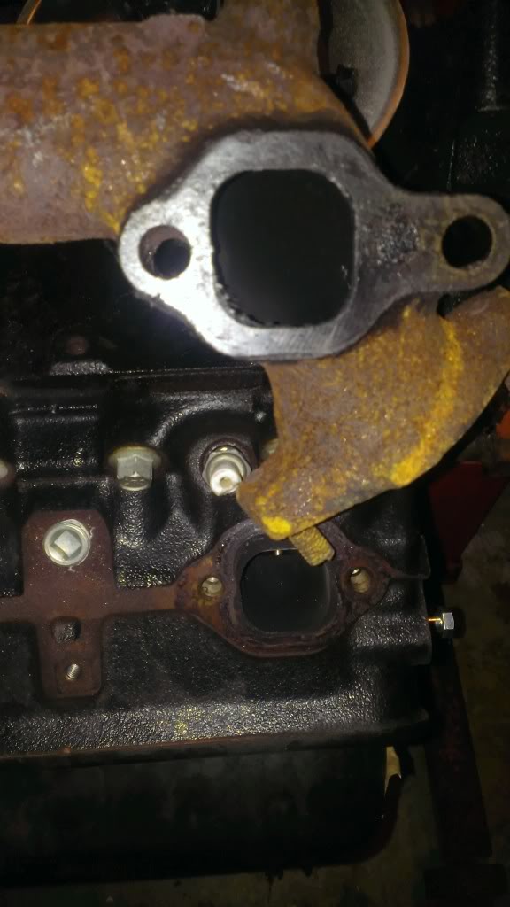

Also a 98 Silverado engine, so your's has the rear most holes mine is missing here?

@Spaceboy - It looks like the manifold is the problem. Due to the exit location, the last bolt hole is spaced away from the #8 port (passenger manifold shown). Finding that bolt location on the head is going to be specific to the original application and non-standard for any old engine/head you use.
The engine shown in the background is upside down, and is either #8 (passenger rear) or #1 (driver front) with standard location bolt holes.
Actually the 7 and later 8 bolt exhaust flange heads are stock and quite commen. My 97 Express built in 96 had a set of 906 castings with 8 exhaust bolts. I have a newer 2002 express engine with only 6 bolts in the 062s. The 062s I pulled off my circa 06 crate engine were 8 bolt 062s.
