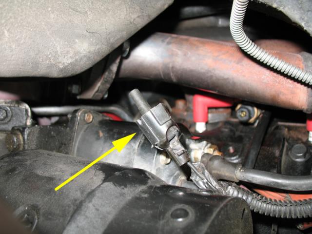

Sorry. No part number is listed. It's just a hardware store item. IIRC, it's a 1/4-NPT male/female elbow.
Even with the elbow, get some fiberglass heat sleeve and put it around the connector. It still gets hot around there. Route the connector between the battery cable and the block.
Most "real" auto parts stores will have a replacement connector hanging on the wall if you need one.
This one was hurt but still in action when I replaced it.
