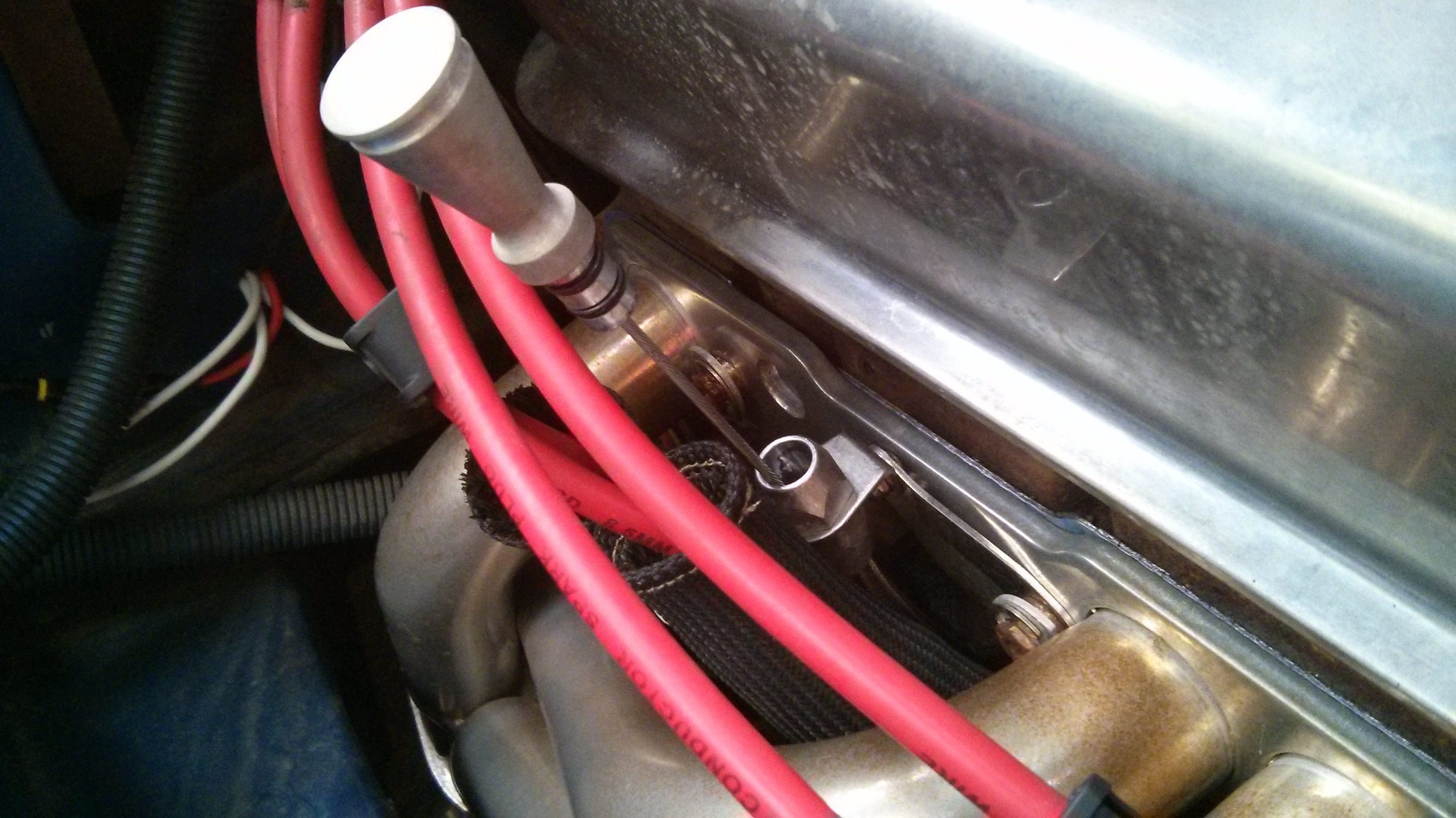

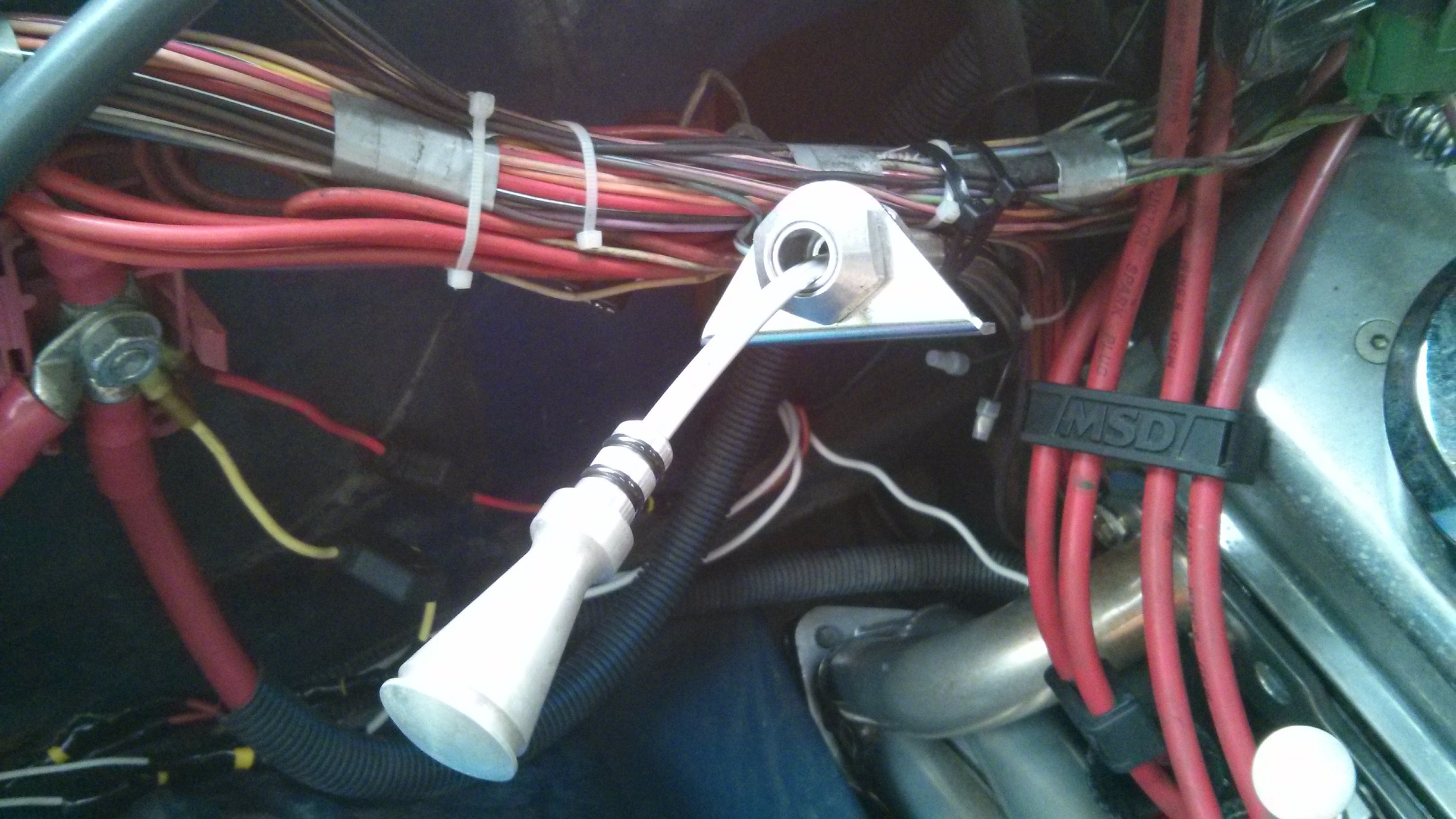

I love Lokar. Still want to get their Kickdown and throttle cable setups. I have their Oil & Trans dipsticks. I'll post pictures later today if you want. Actually, I'll post them anyway. For me it was how they could be installed without sealant (I still used a dab) and how they locked in place with the double o-rings. Just a very nice piece.

Sorry for the wait. The oil dipstick is fully installed. The trans is zip-tied, since it is a bit "short" not the dipstick, but the overall length, to have it mounted nicely on the firewall. I may make a bracket for it off the firewall.
Attached Thumbnails How hard is it to replace the dip-stick?-lokar-oil-dipstick-3   How hard is it to replace the dip-stick?-lokar-oil-dipstick-4   How hard is it to replace the dip-stick?-lokar-transmission-dipstick-2.jpg

That looks good! If I can get this one out, I'm definitely going that route.
