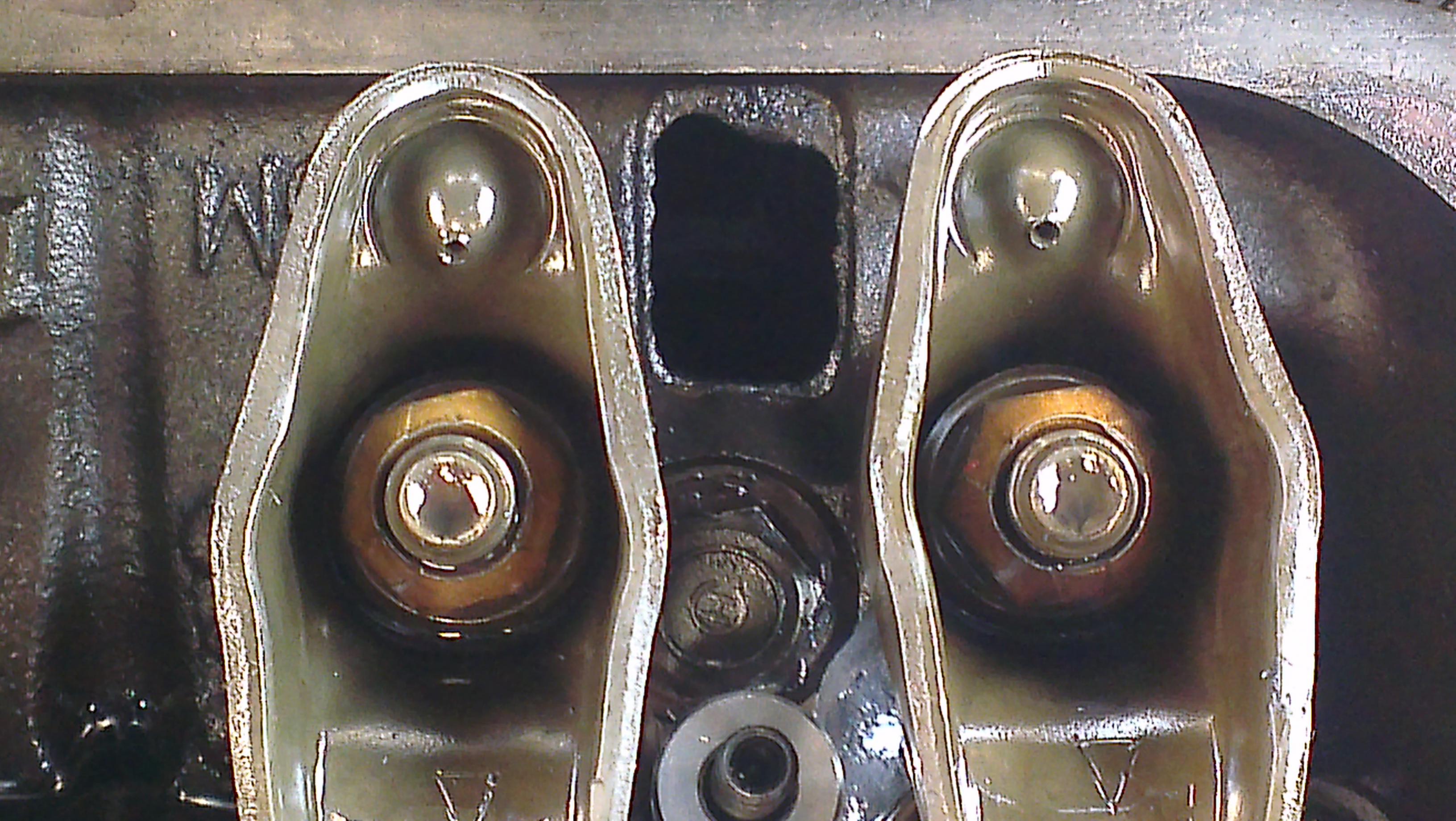

so i was installing some new valve covers and ended up dropping a cylindrical washer that came with the setup down a hole in the head... im not sure how to get it out, if it matters, or what needs to come off to get in there.. please help
attached is a pic of the hole it went down
Attached Thumbnails Need Help dropped a washer down a hole ... where does it go??-imag0347.jpg

Get a telescoping magnet from your local auto parts store and start fishing around to get it. If that doesn't work you will have to take the intake manifold off to get at it.
A magnet will work 99% of the time.

If you can see the washer in the hole, you can try using one of those extendable magnetic pickup tools to grab it.
If not, you'll need to drain the coolant and remove the intake manifold to get to it. That's assuming it didn't fall down the oil drain back holes.

lol i tried a magnet on one of the spare ones i have.... its obviously not metal because it wont stick.... and i just put a whole new intake manifold setup on lol i really have to take the whole thing off again?, will my gaskets be ok? it hasnt been fired yet

If its an alum taper washer, your only solution is to pull the intake and fish it out

Man that sucks.Ttry to get eyes on it and pick it out of there. becareful you don't knock it deeper in the motor if you do see it.

i was able to get in there since it was the back one of course and could actually see it, however it was caught under a lip tried everything eventually was having some luck with a cut coat hanger... until i did just that knocked it down so i cant see it at all now ........fml

around here ,we refer to that as "dave luck". man I hope you can find it. if you were to leave it in there it would probably hurt something bad.

got it out thank god! thanks for the help... to bad i had to pull everything i had just put on a few days before to get it... i guess it really wanted me to know how to do an intake job like the back of my hand lol!
