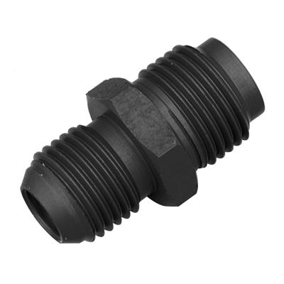

Do it this way instead. Then use the right hose end for whatever hose you're using.
http://www.summitracing.com/parts/ea...7erl/overview/
http://www.summitracing.com/parts/sum-220667b/overview/
That way you can even put a 90° or 45° on your hose, if that will make it fit better.

BINGO!!
We have a winner.
Why couldn't I find that? It's even the same Summit black anodized style I have for the rest of the system. I already have the 90 sweep from pump to filter. All I'll need to do here is swap out the NPT adapter for this inverted flare.
Thanks Sofa.
Attached Thumbnails -6 AN Hose End to 3/8" Inverted Flare Adaptor Needed-adapter.jpg
