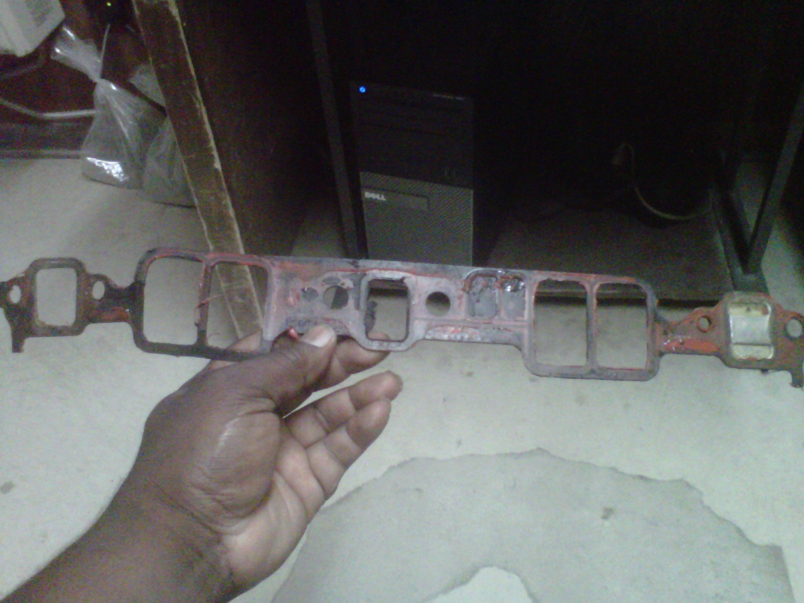

thx fellas, the guy put the intake gaskets on the wrong side in essence facing them the wrong way and ended blocking off the major water ports in the front of the engine (aka) the thermostat ports from each other which in turn started those ports to collecting some not too good gunk from th water not circulating. these are the type of gaskets used:

some more pics: as you can see the block off plate that is clearly labeled "rear port" was blocking off the front major thermostat port in the front of the intake so I need just a little advice then I'm going to cover the oil galley, clean as much of the gunk out of the water port as I can, get new gaskets, use just a dab of rtv esp. on the front and rear gasket, give her a full tune up, replace her belts and hoses, flush her radiator and system, and get her some antifreeze and we should be good to go of course this will be after I take my time double and triple check to make sure I don't make the same mistake.

what is the center most port for? some of the gasket sets I have seen for an 87 caprice classic brougham have this port blocked/partially blocked. I want a set that has every water hole in this stock intake open and ready for flowing this is the stock 305v8.
and why do they have the rear port blocked on this gasket set anyway. I checked advance auto and they do list this design as one for this car but why in the world would you block off any coolant port if the car is not for racing?
