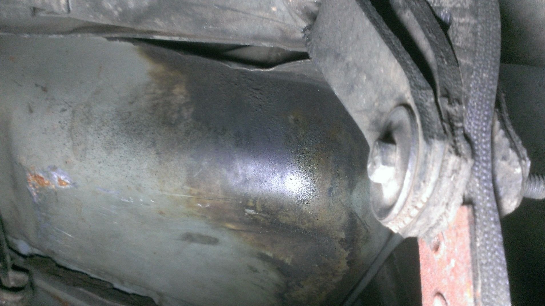

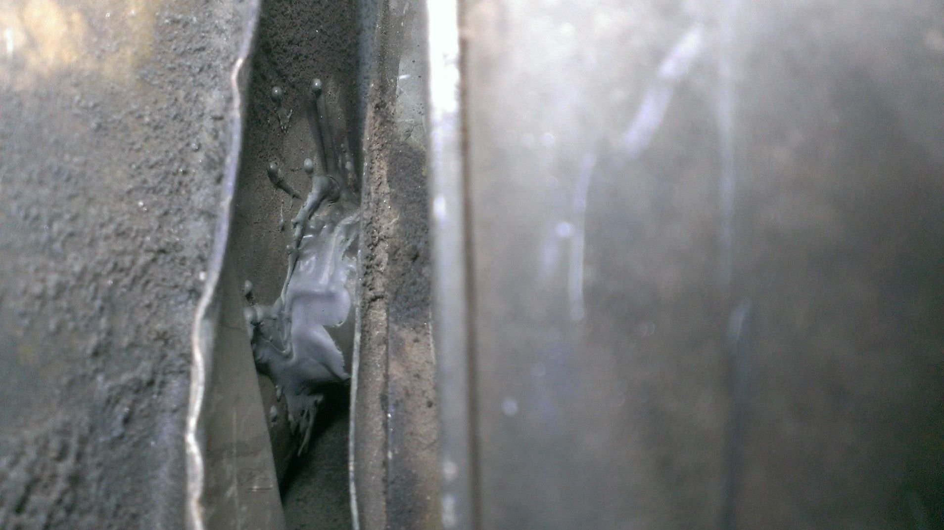

Thanks Someone972, those lines checked okay. I got up under the rear the other day and saw what a previous owner had done. JB Weld around the filler neck and the tank under that area had been getting wet. Ordered a new tank kit and will be doing it next week.
Note the JB Weld around the filler neck.
Lower corner of tank has been staying wet.
