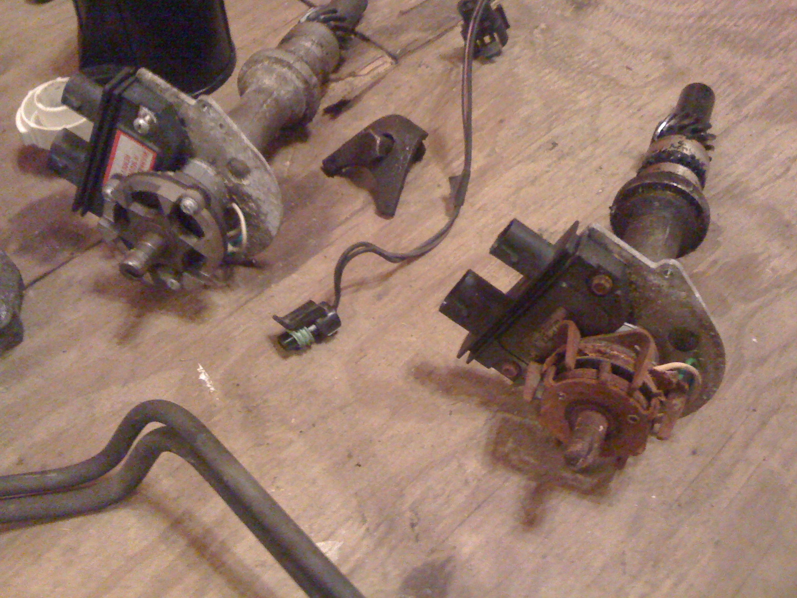

Yep , a pain in the butt for sure . I will post up a photo of a distributor suffering from the very sludge ridge I'm talking about . See the rusty distributor on the right hand side of the photograph ? See the black , flaky substance in the ridge ? And how that is not seen on the clean distributor on the left ? It is that carbonized sludgy crap that is the only thing standing between you and success .
Again , I hope my method works for you , it removed that very sludgy unit in the photo
