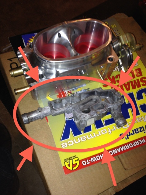

I actually do live in AZ. My heater core was bypassed awhile back so I guess I still need to re-rout that bottom hose off the hcv.. Where would you suggest I plug that line into to make a complete circuit? The easiest way

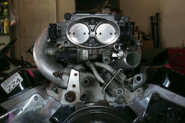

Well, you could go straight from the tb down to the T where the top hose connected to the heater core out pipe/oil cooler. I think the tb hose and the hcv top hose are the same size--I think. It would just be a matter of getting a preformed 90 degree 5/8" hose that is a little longer than the one on the hcv in the top end. The one there MIGHT reach the tb on its own if you stretch it over, I'm not sure, it's something you can check. The angle may be wrong, you might need to clamp the diverter hose and tb hose to an elbow. But I'd go ahead and replace all the hoses now while you've got it apart. If they're older, the seal won't be the same after you've broken it. I just had to do that to mine this fall. New hcv, new hoses, etc. cuz I live in IN and need heat! But, you might get some more opinions from other guys on here. I THINK what I've said here would work if you want to totally bypass the htc. But I'm not as expert as others, they might have smarter ideas......

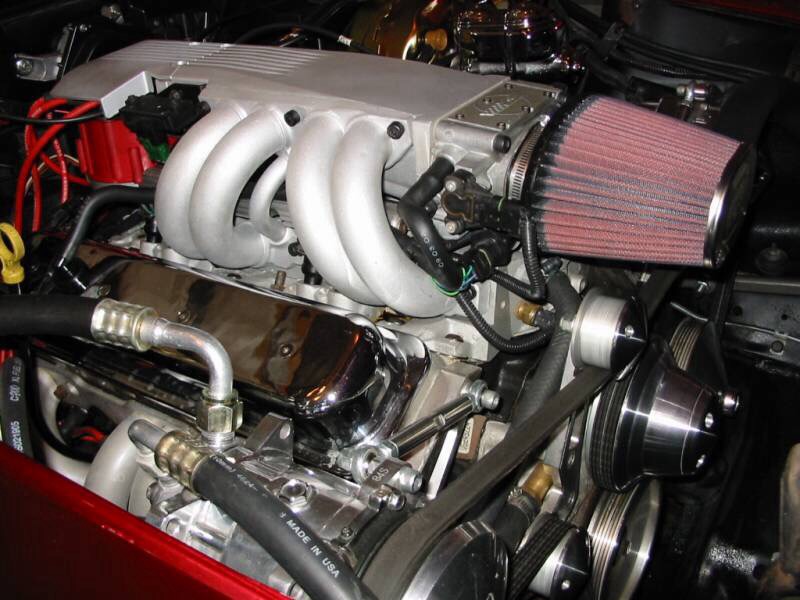

Here's a pic of my motor. See how that top hose bends down toward the bottom of the motor? Oil cooler line and T from the htc is down there along the wheel well. I guess technically there are two 90 bends in it.....

I really appreciate you writing all that out but I'm still confused. This is what my HCV looks like right now. Can I just delete this thing and rout the hose somewhere else? Not sure if I have an oil cooler...

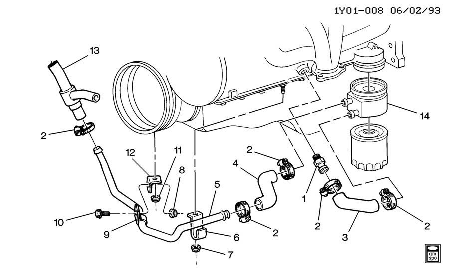

Look under your motor. If you have an oil cooler, there will be a couple hoses/aluminum lines running around the front under the crank pulley into a bracket that your oil filter is screwed to. It goes in one side, then back out the other so there would be two parallel lines. IDK the differences in years and Firebird/Camaro, but the general idea is the same. You have three hoses hooked to your hcv, right? The short one in your pic connects to the tb, the one you have blocked off went to the htc, and the upper one directly across from the tb hose is the one that allows coolant to be diverted when AC is selected. The coolant comes into the hcv from the tb, then goes DOWNWARD to the bottom hose into the htc when heat is selected. When you select cool, a valve opens at the top hose and diverts it. You already have your bottom hose blocked off I see, that's from were you bypassed it? So then no coolant is going INTO the htc. What did you do with the OTHER htc line, the one that comes OUT of the htc? Whether you have an oil cooler or not, that line coming out of the htc had to go somewhere! I imagine you need to connect the line coming out of the tb to whatever that htc line out was connected to. On mine it comes out of the htc down the firewall, then over toward the passengers side wheel well into a 3 way T that goes to the oil cooler and also accepts the coolant divertd from the hcv when AC is used. I don't know without looking at your motor, but to delete the hcv, that's probably what you'd have to do. Find out where the out line went, block coolant from going back toward the htc and come down from the tb. But like I said, without looking at it its harder for me to tell,,and maybe someone else knows an easier way.

Hmm, let me think. Check to see if you have an oil cooler. It looks like this. If you do, there would be a T, and that's where you could tie in. Where did that upper hose on the hcv connect before you took it apart? If your htc out hose is laying there "dead" and you have an oil cooler, he also blocked it off at the T. Otherwise coolant would flow right out onto your manifold! If it's laying there and you don't have an oil cooler, it'll take more thought..... Your idea of connecting the one from the block to the tb might work, just very difficult to tell without actually seeing the setup, esp since you have an IROC and I have a Formula!
Ok so I was wrong it doesnt go to the block but the oil cooler through a metal pipe under the pulleys. So do I leave it in the oil cooler then pull the end that is attached to the top of the hcv and put it somewhere else?

Ok, now we're talking! If you follow those oil cooler lines, you'll find they split on the front passenger side of the motor. One goes to the top of the radiator right under the cap, the other to the infamous T that connected to the htc out line. The bottom of the T (it's an "inverted" T) connects the OUT line from the HTC to the oil cooler line. The part that points upward is where that top hose from the hcv should have been connected. This is where coolant was diverted when you select AC at the controller. So you'd need to run from the tb into the top of that T, and make sure the part of the T pointed toward the htc is blocked off, and it probably already is if your out line is laying there "dead". Like I said, maybe someone smarter than me knows an easier way, but that's how I'd do it.....

The the one I have circled I can pull off and attach to the tb?
Also what's the bottom inlet for below the one I circled. (I really should have payed more attention taking everything apart...)

Yeah, that should work. I see the confusion now. Either you or your mechanic took the T out and replaced it with a coupler when you bypassed the htc, which was a good idea. But yeah, that is connected to the oil cooler! See where they split there? That coupler is where the T used to be, so it looks like you're on track with that idea. I'm a bit of a novice myself, it's just that I just got done messing with all this on my car last month tracking down some coolant leaks. Hope this works out! Keep an eye out for supreme members with better ideas, but I think that should work....

Your aftermarket TB does NOT have the coolant passages (cold weather anti-icing), so your heater lines will NOT go to the TB. However, the hose marked with the red circle can/should be attached to a port/fitting at the front of the intake manifold. This will supply coolant to the oil cooler, which returns to the radiator.
As for the TB vacuum lines: Top goes to the valve cover for PCV, bottom goes to the charcoal vapor can.

Ok, so the after market tb's have different plumbing. I still use my stock tb. This is why I wasn't 100% sure about what I told him, and advised him to keep an eye open for something else. His tb looks just a little different than my stock one, and now that I think about it I remember mine has three fittings, not just two. And yes, he needs to make sure he connects the ccv line, even if he plugs the evap line. He's running an 89, mine is a 92--so no doubt there are differences that I'm not sure about. Thx for adding this in!

I think this is it.... See the hose fitting at the bottom of the tb on the right? This is stock I think. The U shaped hose connects to the other hose fitting there near the middle of the front of the intake. That's probably what Mojoe was talking about. If your new tb doesn't have that bottom hose fitting, then connect your heater line to this intake port. You may possibly end up needing a different shaped or longer hose.
Attached Thumbnails A/C and A.I.R delete, did I remove too much... (PICS)-image.jpg

Here's a pic I just found showing someone else who did what you're trying to do. Looks like they just connected the hose to the intake and routed it down behind the pulleys. Dang it, man, I wish my motor looked this clean and dressed up!

@nakota2k
Picture #1 shows the aftermarket throttle body and the factory Idle-Air-Control (IAC) housing / TB coolant manifold. You MUST install the IAC/coolant housing onto the TB... a) because you'd have a BIG vacuum leak, b) the computer would not be able to control the engine idle speed, etc.
- The port pointing at the "d's" on the book is where the U shaped hose from picture #2 connects.
- The port pointing to the left in the picture goes to the Heater Control Valve,
- This is frequently bypassed so keep the TB cooler, with the intet of not heating the intake nor air, to aid performance.
- heater hose runs from the HCV to the heater core and to a T on the metal pipe on the passenger frame rail.
- The metal pipe connect to the oil cooler supply side. (Or straight to the radiator for non-oil-cooler cars).
Picture #2.
- yes the brass piece is "just a fitting". Either 3/8" NPT or 1/2" NPT on the manifold side to allow a 5/8" or 3/4" heater hose to attach.
- The Edelbrock intake manifold you ordered is "missing" a lot of things. These are intended to be swapped over from your old manifold.
For instance, the U hose, and its brass fitting should be unscrewed from the old manifold, and screwed into the new manifold with teflon tape (to aid sealing the brass fitting into the manifold).
You can route a heater hose direct for the intake manifold fitting in #2, skipping the TB and HCV, and going straight to the rear most hose/pipe for the oil cooler.

Here are some pictures:
1) aftermarket 58mm TB with factory IAC/coolant housing installed along with IAC and TPS.
2) stock coolant passage cut off IAC housing to provide JUST IAC without the coolant ports sticking out.
3) Aftermarket IAC-only housing, with no TB coolant passage.
Attached Thumbnails A/C and A.I.R delete, did I remove too much... (PICS)-58mmfull2.jpg   A/C and A.I.R delete, did I remove too much... (PICS)-tb-coolant-bypass.jpg   A/C and A.I.R delete, did I remove too much... (PICS)-iac001.jpeg

Originally Posted by MoJoe
@nakota2k
Picture #2.
So you're saying I should keep the stock IAC housing. Use the front port and the U to connect to the intake and the side port connect the hose that used to go to the top of the HCV?

Re: A/C and A.I.R delete, did I remove too much... (PICS)
Originally Posted by nakota2k
This is what I need, I just can't find it anywhere.
What can't you find? The die grinder, pliers, or sheet of plywood? You already have the part(s) in the picture. You just haven't cut it apart yet.
That part would be found on your stock throttle body, and needs to be transferred to the new TB.
Attached Thumbnails A/C and A.I.R delete, did I remove too much... (PICS)-2z6ysso.jpg
In your opinion would you keep the stock IAC housing or use that smaller one without the coolant passage?
The stock IAC housing is free and you can modify it for free.
Or spend $75 for TPIS billet bling that no one can see.
That is the factory coolant routing.
Bypassing this may or may not have any real world performance improvement.
If you want to bypass the TB coolant and/or have simpler hose routing...
a) leave the IAC/coolant housing as-is, and just don't connect a heater hose to either side.
b) cut the coolant passage off, so you have just the IAC housing.
c) or, buy the aftermarket, billet, IAC-only part.
Choose EITHER a,b, OR c, AND run a heater line from the brass fitting in the intake manifold to your HCV (if you are keeping it), or your heater core (if you have it, and want heat in the car), or to the oil cooler, or to the radiator, or replace the hose fitting with a plug if you don't want the hose at all.
Can you link me to one of those after market billet IAC only housings please? Can't seem to find any.
Here is the link from post #40... TPIS billet bling
So Im going to just connect the line that went to the top of my HCV (which I deleted) and instead take it right to the intake.
That sounds correct.
I've learned so much in this thread as well.
Good to hear it!
Yea that looks real nice. Do they make a IAC housing without that coolant section. I can't seem to find any. If I run it straight to the intake like that pic then those two ports on the IAC housing will just be open. Also how did this guy do a maf delete like that? I would love to have the air filter right there
He probably never had maf. My 92 doesn't, it's map only. I have a K&N in this same position. It varies from year to year. Some cars earlier than mine had maf, and some after have it again. I'm not sure what the engineers' logic is about why and when they do it.
