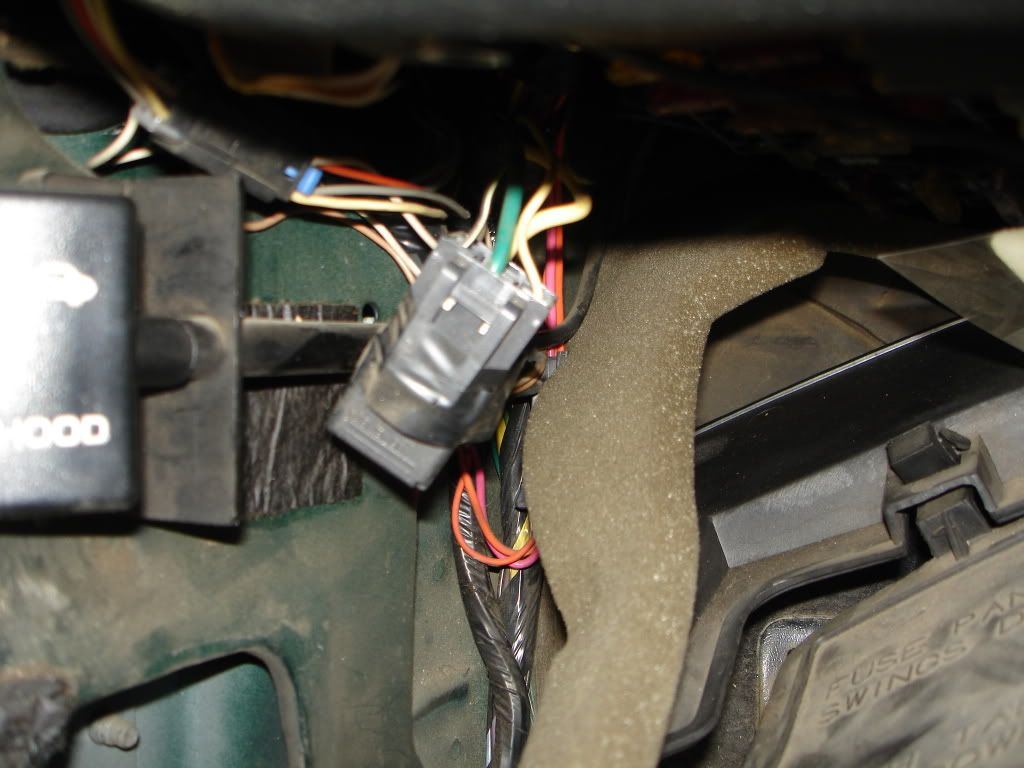

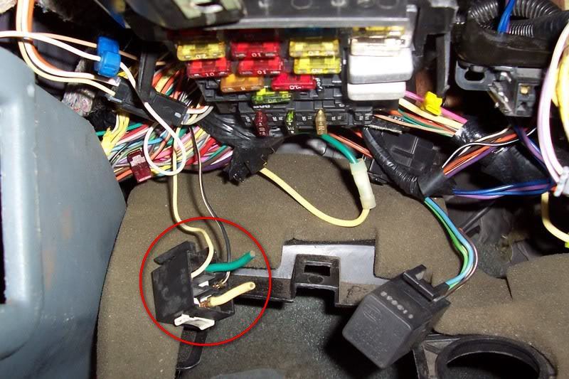

So, checked it and I couldn't get a reading off of it. But I didn't know which wires to check. I think a purple and a green or yellow of same gauge. But there's a box under the dash by the hood latch, and it's got a small lever on it with wire coiling. I pushed the lever and turned the key and the starter activated and turned the engine over. But I haven't been able to do anything else because I had to leave for work. Starter activation relay?

Hmmm, that don't sound stock to me. I have not done a '89 but I have restored an 88, two 84's and owned a few others and I just can't remember seeing anything like that on any of mine

Alright, I've tried to insert a picture of it on here from somewhere else. It looks very close to the picture, except the black vats wire is green on mine. I thought it was called starter enable relay. Not really sure what im getting myself into.

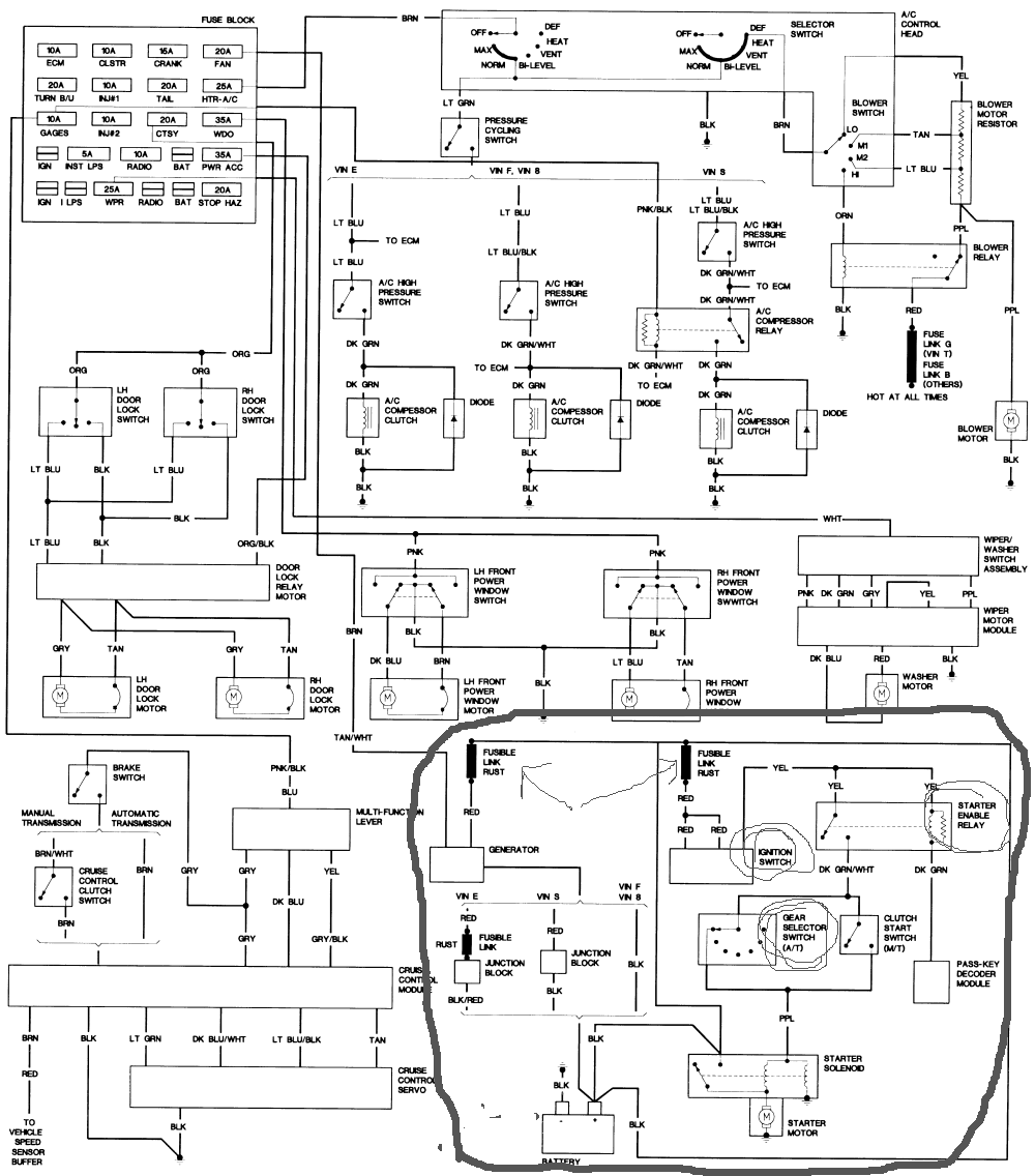

Found the wiring diagram for it.

Well, Randy, the wiring diagram I posted with the starter enable relay is for year 89, so I'm assuming something changed in production unless you have spliced wires from a previous owner bypassing it. My cars grounded twice, besides, it just started.
