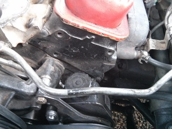

Zarathustra's Avatar
Joined: Apr 2015
Posts: 15
From: Phoenix, AZ
Car: 1987 Firebird Formula
Re: power steering

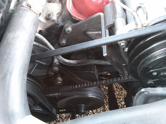

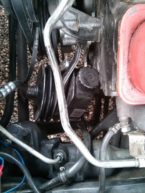

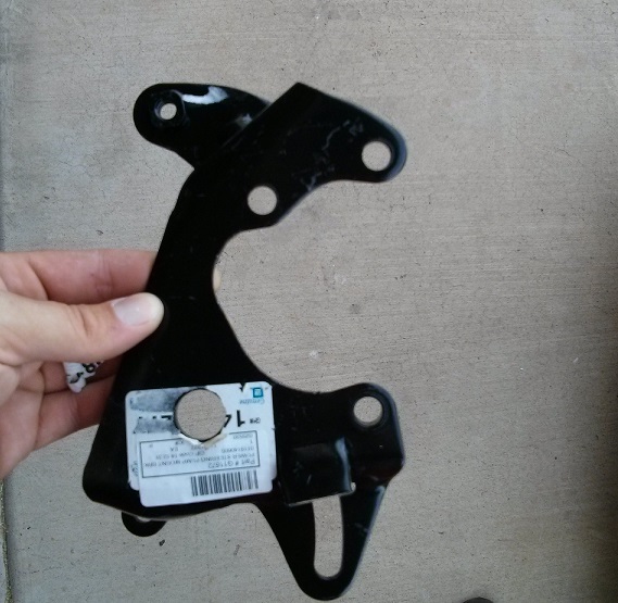

PSB.jpg: My new bracket from Classic industries
PSB1.jpg: Previous owner's cheesy bracket. Note A/C retrofit bracket from Classic Auto Air
PSB2.jpg: Removed A/C compressor. 3 bolt holes for A/C bracket

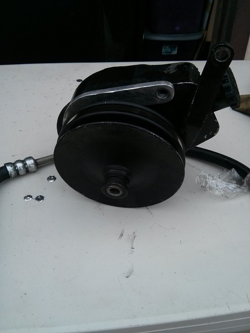

PSB3.jpg: Unmounted Power Steering pump
PSB4.jpg: Previous owner's cheesy brackets
PSB5.jpg: Pump with pulley removed.
Attached Thumbnails power steering-psb.jpg   power steering-psb1.jpg   power steering-psb2.jpg   power steering-psb3.jpg   power steering-psb4.jpg
Old Apr 23, 2015 | 12:12 PM
Joined: Apr 2015
Posts: 15
From: Phoenix, AZ
Re: power steering

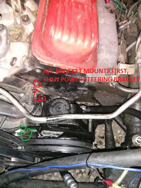

PSB6.jpg: Remounting the pump. Currently attached at two points of contact shown. Need to invent something for the third point of contact off to the right side of the bracket.

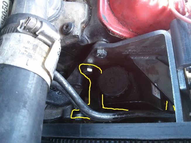

PSB7.jpg: All finished. Bracket outlined in yellow.
Any questions/comments?
