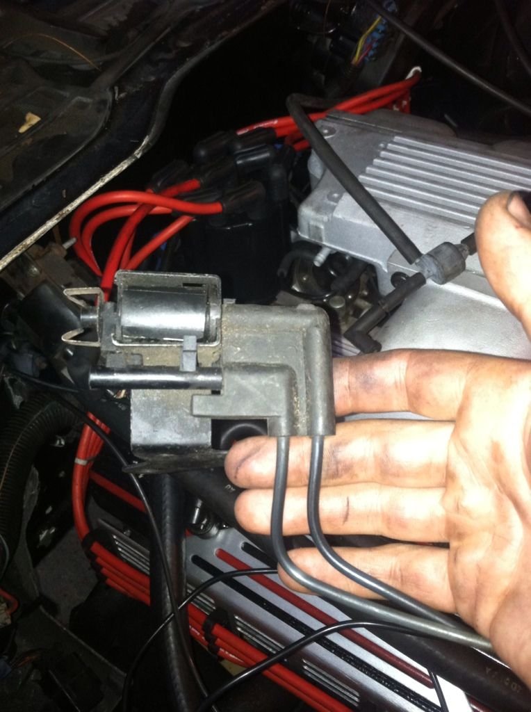

Need help with EGR solenoid lines. Which of these lines runs to the EGR valve. 1992 tpi Camaro

The top port I believe vents to the back side of the solenoid, that goes to the egr. I don't remember for sure if it vents when energized or not but either way the port that connests to the vent on the back side will always go to the egr.
