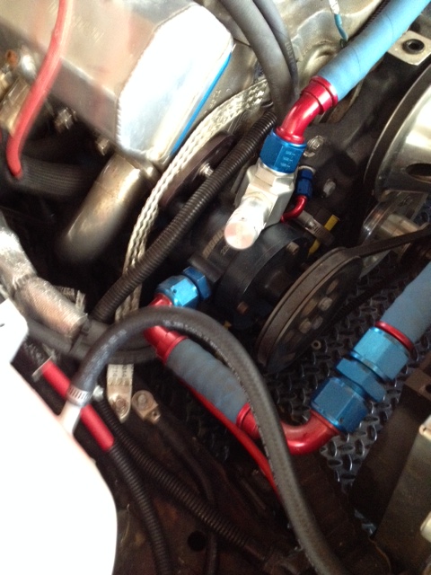

Don't rush to blame the starter.
A poorly grounded system will do the same thing & so will poorly connected old/damaged/corroded battery cables.
if you are using side posts make sure you have not stripped the holes in the battery.
A quick test with a multi-meter will tell you if you have a ground issue.
with the car running you should be seeing over 14V at the battery if not you have a potential grounding issue. (could also be corroded wiring)
You can also check for voltage drop to the starter.
A fully charged battery at rest should have at least 12.6 V.
Then test the voltage at the starter when cranking.
The starter should be getting full voltage from the battery, if there is more than 1V difference (voltage drop) you have a grounding / battery cable issue.
The starter is grounded by it's connection to the engine block, the problem is most likely you are missing a ground cable from the engine to the chassis to complete the path to ground from the starter to the battery.
Make sure the battery cables are intact and not shorted out on the exhaust manifold/header.
Check the condition of the negative battery cable, it should be connected to the chassis, if the connection is corroded or the cables are old you should clean the ground connection and replace the cables.
Use 2 ga. cable. The smaller 4 ga cable can build up too much resistance when hot.
the engine should have a heavy gage ground strap from the block and or cylinder head to the chassis.
On my car I installed new ground straps; #4 on the passenger side cylinder head to the chassis & 0/1 from the block to the chassis on the driver side. problem solved.

properly grounding the system is very important.
The starter draws the most current.
The alternator produces the most current
If these 2 components do not have good paths to ground
all sorts of problems are possible.
This is now my voltage with the engine running and both radiator fans on. Prior to adding the engine grounds and replacing my battery cables it was only 13.8V
( the alternator was not charging the battery at full capacity)
I no longer have a hot start issue, it fires right up with no starter hesitation whatsoever.
I am using a MSD starter.

The electrical systems in modern automobiles have the negative battery terminal connected directly to the frame/chassis of the vehicle.
This is typically a large integral stud or bolt close to the battery which the negative cable attaches to.
The engine is grounded to chassis with ground straps.
The body/frame/chassis of the vehicle serves as the return path for the entire electrical system of the vehicle.
Older vehicles did ground the battery cable to the block for the starter & alternator.
The reason for the switch to a frame/chassis to battery ground connection is the increase in electronics require a more secure ground.
This is also done as an "upgrade" in older vehicles that have added high output stereos and other accessories.
A trunk mounted battery follows the same concept:
The negative cable is connected to the frame/ chassis in the trunk, the engine block is grounded to the chassis at the front.
There is no need to run 15'-20' of heavy gage negative cable from the trunk to the engine block since the chassis is the path to ground for the battery.
