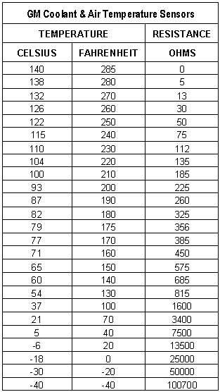

Coolant temp switch on front of the intake or Intake Air Temp might be bad.
I thought the same as Edge about the injectors leaking down giving yo a hot soak condition, but you changed those.

The coolant temperature sensor that I replaced is on the front of the intake. Not the sending unit in the left cylinder head. I replaced all eight injectors with brand-new Accel 21lb ones. There are not any leaks. When I say that I hold the accelerator pedal to the floor during starting, it just helps it to start. If I do not do this then sometimes it will not start at all. It acts just like a flooded condition on a carbureted engine. With the accelerator held down, more air is let in then it finally fires, a bunch of smoke comes out of the exhaust, probably from the excessive fuel burning off, it sounds rough then smooths out after a few seconds and everything is fine. I am wondering if the injectors are spraying the correct amount of fuel but for some reason, the plugs aren't firing? I know the ECM will prevent the injectors from operating under certain situations but is there a situation where the plugs will not fire? By the way, my plugs do look good.
