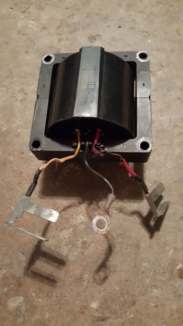

Can you post a picture of the old coil / ground wire? A lot of the aftermarket coils do not use the strap. They have a black ground wire coming out of center of coil the other end of that wire has a metal tab thing soldered to it. That metal tab thing pushes down into the dist. cap and your factory wiring harness plugs up into the dist. cap.
Stock or stock types had a short ground wire with ring term on it and a metal tab thing. The wire and metal tab thing both went under one of the coil hold down screws, metal tab thing sticks into dist. cap

Both the old coil and the replacement coil had what you describe as "stock or stock types". I'll snap a picture of the old one when I get home if I don't forget.

Wow, that thing looks to be in bad shape. I'm not sure if it was a ground prob or if it was shorting to ground. The red wire being bare like that could have touched the coil body or one of the metal tabs.
Also the yellow wire looks pinched in a couple of spots

Yeah, when we saw that we thought for sure that was the root of the problem, then replaced that w/new and promptly fried the ICM. I put in the new pickup coil and the ground strap at the same time, so it could be either. Not sure I care. It runs and I'm happy about that!
