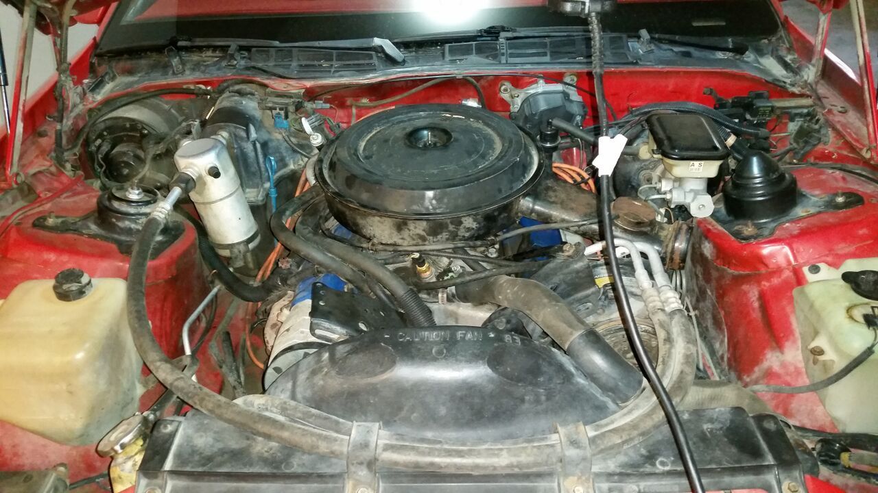

Swapping to an open element air cleaner assembly on 85 Berlinetta 2.8l V6
A little confused on the extras left behind and what to do with them. I have a small hose that was connected to the old air cleaner which I've read should be clipped and plugged. Then the pvc can be connected to the new assembly from the bottom and adapter it came with. So far so good, I think.
Last I have this gaping hole on the right side that had a metal hose of sorts attached to it and the old assembly, does said hole need to be plugged as well?? If so, would you say it's safe to drive with it open to grab a plug from an auto store down the road?
I can post a pic if needs be. Thanks!!

Re: Swapping to an open element air cleaner assembly on 85 Berlinetta 2.8l V6
It's the gaping hole towards the bottom of the pic.
that is most definitely NOT a 2.8 V6..
that being said, buy a breather to put in the hole in the valve cover where that breather hose is... plug the vacuum port on the carb where the heat riser valve in the air cleaner hooked up.... and forget about that "gaping hole" in the driver's side exhaust manifold heat shield: it's just to get hot air from around the manifold up to the air cleaner for better cold starts..
all that being said, why are you getting rid of the stock air cleaner? unless you are putting in a 14X4 element and have an engine making over 400hp, it will make just as much power as an open element with a good filter in it and the cold air intake hose hooked up to the top of the radiator support- and maybe more from the cool air being fed into it- and will deliver better fuel economy... plus, the hot air from the manifold really does make a difference in cold start driveability up to about 50 degrees or so.. believe it or not, those guys at GM that designed these things were pretty smart..
one thing that can't hurt if it is a stock F body air cleaner is to take out that goofy little round breather element inside the big element. i'm not sure what it was for, but it just gets in the way of the air that the engine is trying to breathe..

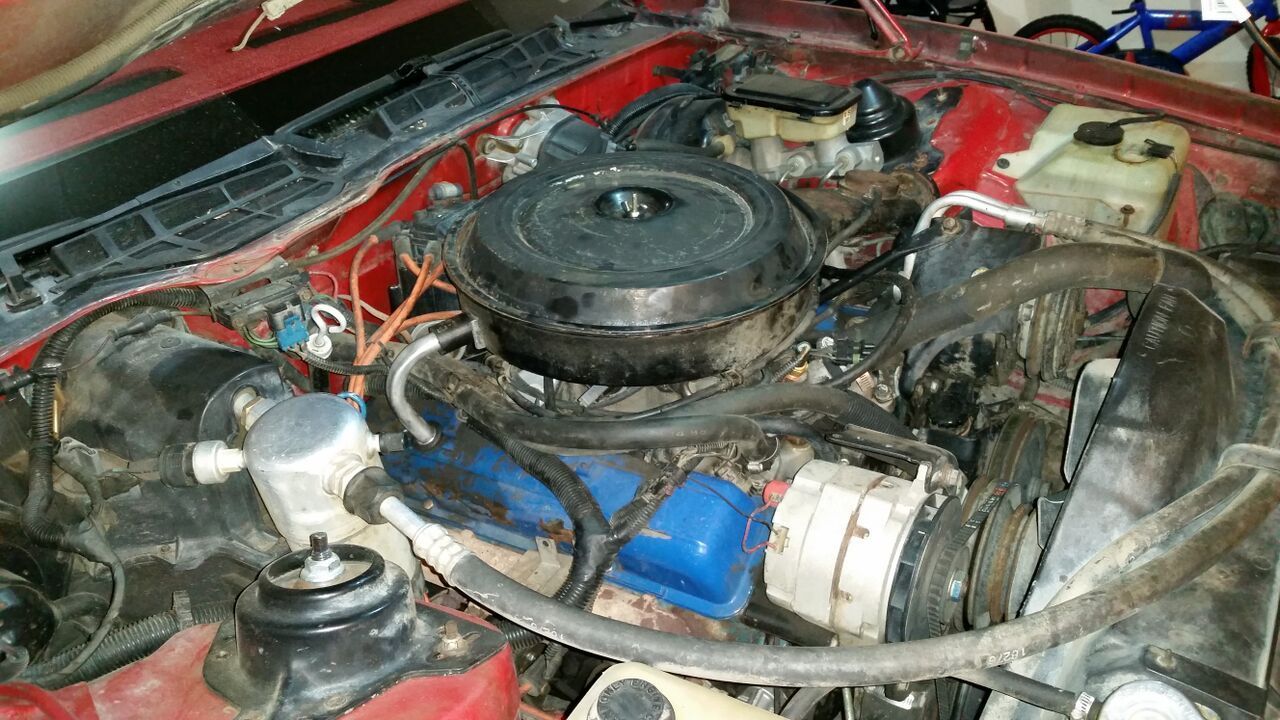

Novaderrik,
Ahh, I'm actually a little embarrassed I missed the fact that I have 8 cylinders. So I have a V8...neat. Thanks for pointing that out. So I decided after what you had to say and a little more research, it's better in most cases to stick with stock if not alter it as you have.
I threw the stock back on after cleaning her up a little and swapped the old air filter for a new K&N one. I know, I know, they're garbage but it was the only one available at the time that fit.
Here she is put back together.
The aircleaner thermac valve opens the trap door in the snorkle causing the motor to take in air that is 'pre-heated' by passing through the heat stove around the driver's side exhaust manifold. The heat stove should be connected to the thermac valve by a short aluminum flex tube. The vacuum source for the valve should connect to the carburetor at the vacuum tee front, passenger side. This tee also provides a vacuum source for the choke pulloff.
If you are missing the flex tube from the heat stove to the thermac vent, replacements can be had at most parts stores.
Always replace plugs, wires, cap and rotor before committing any other resources to the motor.
Note that you've got non-stock wires on there now. Stock style will have six angle boots and two straight boots. The straight ones go on #2 and #4. Odd bank wires will go underneath the exhaust.
You've also had a mech qjet and mech dist installed and your AIR tubes and system have been removed.
Your air cleaner lid does not look stock. A stock replacement air filter may not be tall enough to work.

I honestly only got about a fraction of what you ment there, learning my way through this bit by bit. The cleaner lid was changed by the previous owner before I drove off with it and at the time and I thought he was putting on the stock lid.
I have no A/C but plenty of heat so I believe I know what you mean by removed air tubes and system, which why he did that is beyond me.
