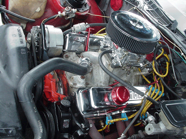

Sorry its long but im desperate for help!
Car losing power!
OK lets assume the distributor / coil is good, wires are not crossed, everything sparkwise (heh) is in good working condition. Advance at Full open hits 36-37 Degrees (3500 RPM) and idle advance is roughly 15 below that.
Now, The car just received a Edlebrock 600 Mechanical Carb. Plugs are satisfactory (white / tan iridiums stay kinda white i guess) Headers are not red hot.
In park, no load, car Revs up fine, fast, perfect, no backfire, no miss.
In drive car seems to want to pull.... up to about 3500 RPMS. (that happens to be my stall speed, 3000 - 3500)
After that the car LAGS bad, no power, takes forever to get the RPMS up to 5K.... then i shift and it lags even worse in second. NO POWER AT ALL im lucky to have 200 horsepower, if that.
DOES NOT MISS or BACKFIRE so i know the spark is getting to all plugs or else unburnt gas would cause backfire and plugs would be black.
Few things come to mind; MAYBE:
* CARB LEANS OUT UNDER LOAD (can this happen but not at idle?)
* BAD ROCKER ADJUSTMENT (They arnt, i Checked.)
* Under load, Distributor advances INCORRECTLY (????)
I checked so far:
-Car has correct amount of oil (Too much = slow car)
-Car is advancing correctly at idle
-Air / Fuel at idle is perfect
-Rockers are finger tight + 1/2 turn (done correctly im 99% sure)
KEEP IN MIND this car was running low 13's high 12's with its old transmission, Camshaft, and carberator. nothing besides those 3 things have changed since then. The new cam is a Blazer, 234/244 @ .050 and .489 / .510 Lift After my 1.6's
Maybe this will help:
-I changed the carb because my old Holley 600 DP was suddenly running Crazy RICH after the cam change. Even with 54's (front and back) + 6.5" HG Power valves it would foul new NGK's in less than 4 minutes at idle.
IM about to Soak the car in gasoline and light it on fire and send it off a cliff (anyone know a good place in florida?) because its such BULL$#!^ I cant stand it.
Please dont yell at me if u post this problem on another board too, i am desperate to get it running right, its been 5 1/2 Months now I've been having problems and im so close!
