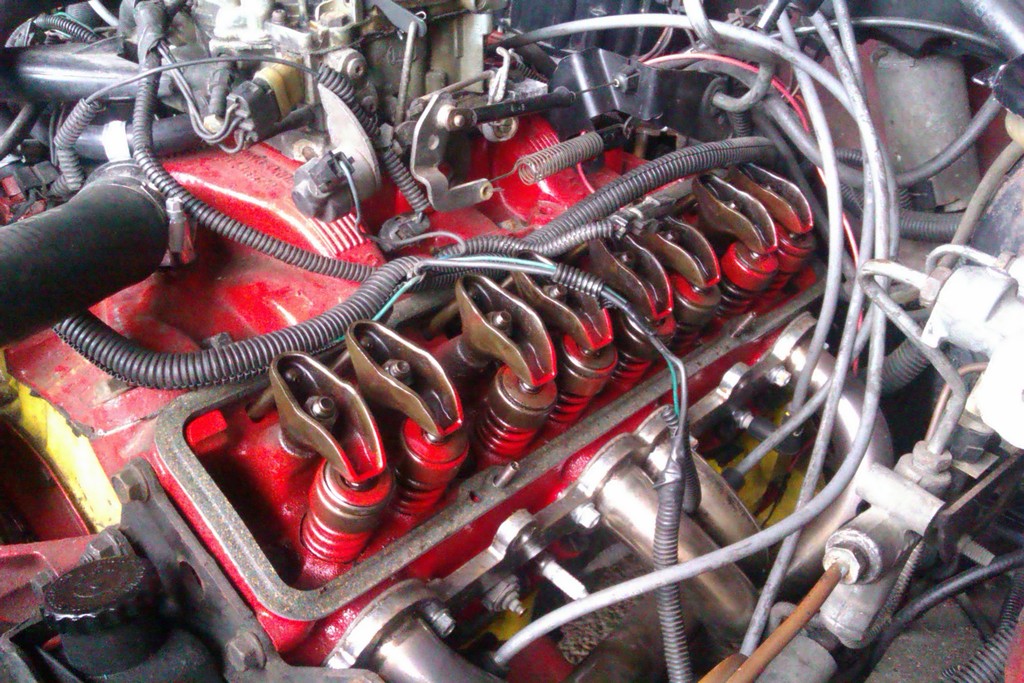

Ok, here's the best pic I've got at the mo':
(please ignore the overspray on the rockers, the PO was a bit of a plonker!)
As far as I know, this is a stock throttle bracket setup, and that's a stock E4ME qjet on top.

Looks mostly normal for an old used cable, except that it's broken.
There's supposed to be a sheath on the bare part, attached to the part that latches into the bracket, and extends up into the tubular part that moves. It's broken off and either has been removed or is hanging out inside the moving piece.
Doesn't look "new" at all to me.

er… yeah, I guess that doesn't really look too new does it?!
By 'new' I think I meant the cable didn't look corroded and worked freely.
I've googled a few pictures and I see what you mean by the sheathe. Does it simply provide some protection for the cable? Do I really need one?
Thing is, I can get one of those Edelbrock brackets over here for about £30+ (around $50), but a lokar setup will cost more like $150 and those billet c-shape brackets about $170-200 once imported!
Plus, I think I'll need to source longer bolts for the carb for the billet bracket, and sourcing imperial fixings over here is a pain…
I know those 'spectre' throttle brackets are cheaper (I've seen a similar one I can get for about £25 by JL Fabrications), but I've heard they're rather flimsy.
So, can I use that edelbrock fitting to take out the slack or am I barking up the wrong tree?

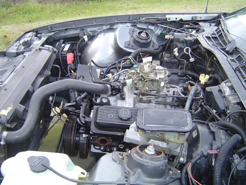

OP: Looks like your cruise cable is broken and you're missing the stud it should attach to anyway. This may, or may not help:
Armybyrd: Stock throttle bracket works perfectly on the performer vortec after just a few minutes with a bench vise. Somewhere in here is a photo:
https://www.thirdgen.org/forums/memb...d-swap-ta.html

in the pic, your throttle cable is connected. the cable closest to the fender that is not connected to anything is mounted where the cruise control cable would go. looks to be a broken TV cable?
Er, are we looking at the same picture?!
I have only a throttle cable; it's a T5 so no TV cable. There are no other disconnected cables...

Upon closer inspection of your photo I now see that you only have the throttle cable connected. Oh well.
