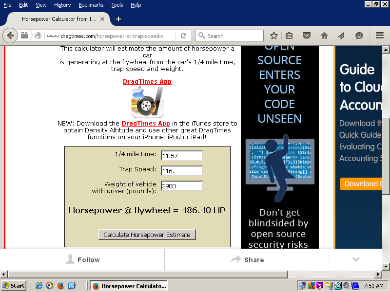

Sounds like we have some difference of opinion. I did a quick internet search (limited myself to 10 minutes since I have no dog in this fight) looking for people posting actual numbers for a FIRST intake and only came across this: https://www.thirdgen.org/forums/tpi/...o-results.html
Although his cam is smaller (212/224) he talked about power dropping off after 5000 RPM.
Also found a youtube video of a 383 (unknown cam and heads) with a FIRST making max power at 4500.
It's looking less likely that the FIRST will be well matched with a 224/230 cam but without any readily available results it may just be an ongoing argument. Post your dyno results!

His cam is too small to support more rpm and the twisted wedge heads werent comparable to what the OP has
The op will be happy with the 503 cam and 185 profilers.
Pipemax will calculate induction system lengths based on 8 harmonic levels. Typically most intakes land in the 2-4 harmonics. Single plane intakes are usually around 9-11" can be 3rd or 4th harmonic. The 2nd is long, 19-20" level for a 355 at 5800 rpm but in addition to this, you need a plenum runner min cross section of 2.1-2.3 inch sq. long small diameter tpi runner wil not support the flow for higher rpm tuning. Big tube setups usually do have abit more flow to support more hp and alittle bit more rpm
You'd have to measure the first to be certain but a combination of length and runner flow area will go a long way to keep hp going in the rpm range. Bigger cam will help hang onto that power without dropping off. This is more area under the curve and extends shifts, gets better et.
Also look into 1989gtatransam's tpi build threads. He did a 369" motor with first base, and i believe 20" long total induction length with custom huge runners and made hp to mid 6000's rpm
