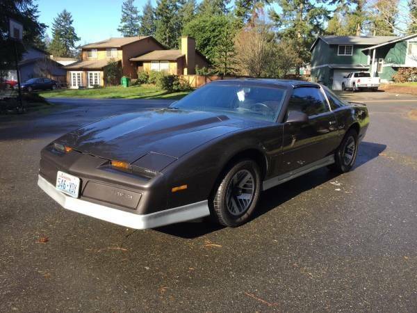

1984 trans am aero package with t tops. Picked it up for 4,000. 70,000 on the gauge, no idea if it's true or rolled. WS6 4 wheel disk and the 5.0 H.O. I'm thinking it's worth a bit more than the 4,000$ I paid. Thankfully the guy had no idea what he had
In all reality , I think $4K is just about perfect , you didn't steal it and you didn't get robbed either . If it's in as good of condition as it looks in the pictures I'd be happy with it just the way it is , no matter which of the two engines it has . One thing to always remember about a 32 year old car is that the options page and the VIN only tell you what it left the factory with , and not what's in it now , Who knows , might even be a well executed 350 swap or the 305 HO could have had a problem and a "regular" 305 put in it's place . Does it go good when you step on it ? And are you happy driving it ? If so , you got your money's worth and hopefully it gives you years of good service

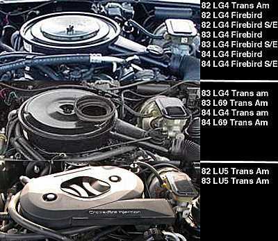

Did The Firebirds With The L69 Engine Use The Same Air Cleaner As The L69 Camaro's.
IIRC, the Camaro dual snorkel wouldn't fit under the 'Bird hood.

Re: Is my 1984 TA a H.O. engine?
Air cleaner should have a lil donut looking deal on top for air induction on the 83-84 HO Trans Ams
