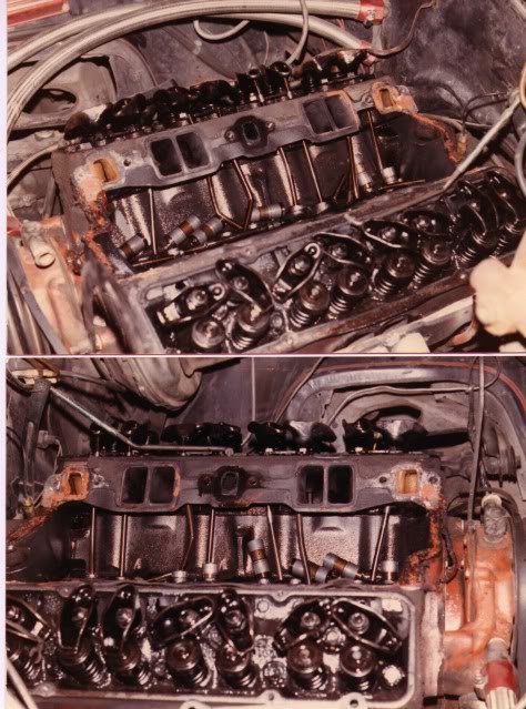

Even SBC's will smash valves when a chain lets go:

Stock SBCs are mostly NOT "interference" engines. However if you build one with dome pistons and a big cam, it can easily become one.
Stock BBCs on the other hand, are.
Yes I have had more than one of each that grenaded the cam gear while I was driving it, and have repaired MANY others: I know this from personal experience.
Neither of those things matters since the engine in question is neither.
I have not the vaguest foggiest dimmest remotest hint of a whiff of a glimpse of a clue about a 6-cyl in this regard however.
