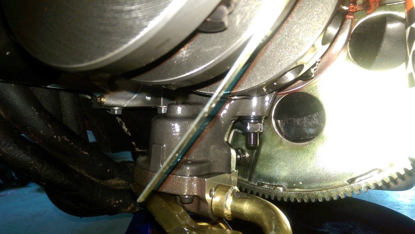

I believe I would pull the #1 main and #1 & #2 rod caps off and have a look.

I did look at the distributor, definitely engaging the oil pump.
here are the pictures for #1 journal as well as #1 and 2 rods
the bearings definitely have some scratches but the journals all still look smooth
