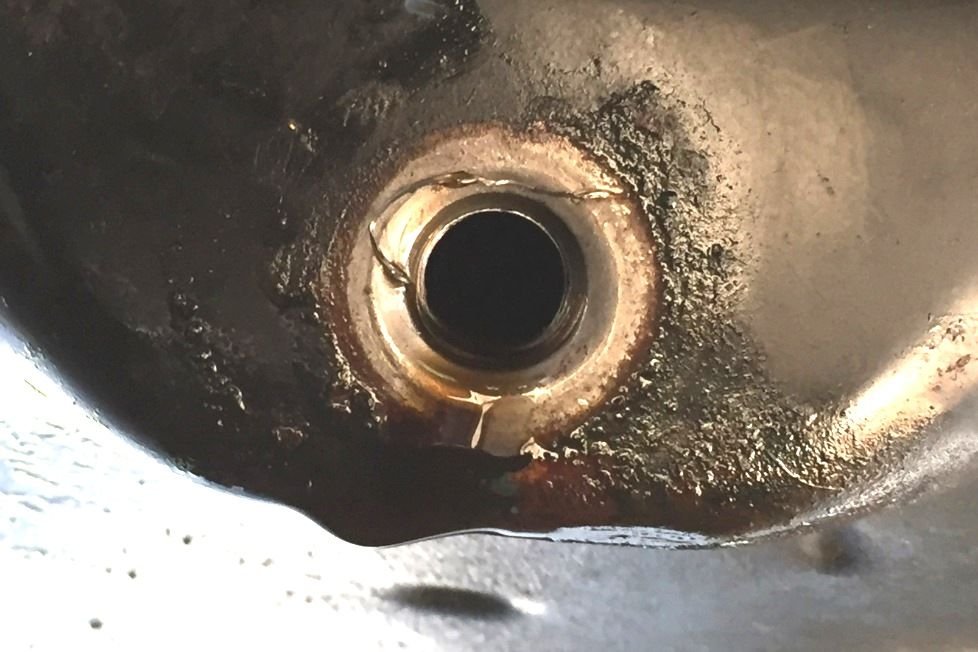

And here is the condition of the oil pan after the plug came out.

I did my very best to try to get the threads on the new plug to marry-up with the existing threads on the oil pan. All I can say is it seemed to be going in straight. The new plug was fighting me back (consistently at least) after I got it engaged about a half-turn. At least it it bottomed-out firmly when the flange on the plug met the oil pan. I stopped wrenching right there.
