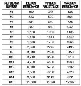

Re: Car wont start (not battery)
Since the starter cranks the engine when the solinoid is excited.
This sounds like a vats issue . If the key reader is not working with conjunction of the passkey module you will not have a active starter enable relay and injector pulse.
You can jumper the starter enable relay to get it to crank if it is the vats not working.
The enable relay is under the drivers side kick panel. Once the relay is removed the two outer wires can be jumpers together. Iirc the two larger gauge wires are green and yellow or purple. There are a few ways to bypass the vats for starting.
https://www.thirdgen.org/forums/elec...ing-v-t-s.html
If you have the 2.8l you should have a 1227302 ecm.
I don't have a pin out for this ecm but the should be a dark blue wire at the ecm.
Koeo if the vats is working iirc you will have a hz signal and 2.5v or so .

So I tested the VATS via this guide: https://www.thirdgen.org/vats/
The resistance matches when the key is off, and I get infinite resistance when the key is on.
Gonna try to find a local store with resistors (RIP radioshack)

It works! Thanks guys
PS: just in case someone finds this thread in the future while searching: My VATS wires were 2 white wires inside an orange sleeve; not yellow like the guide says.
