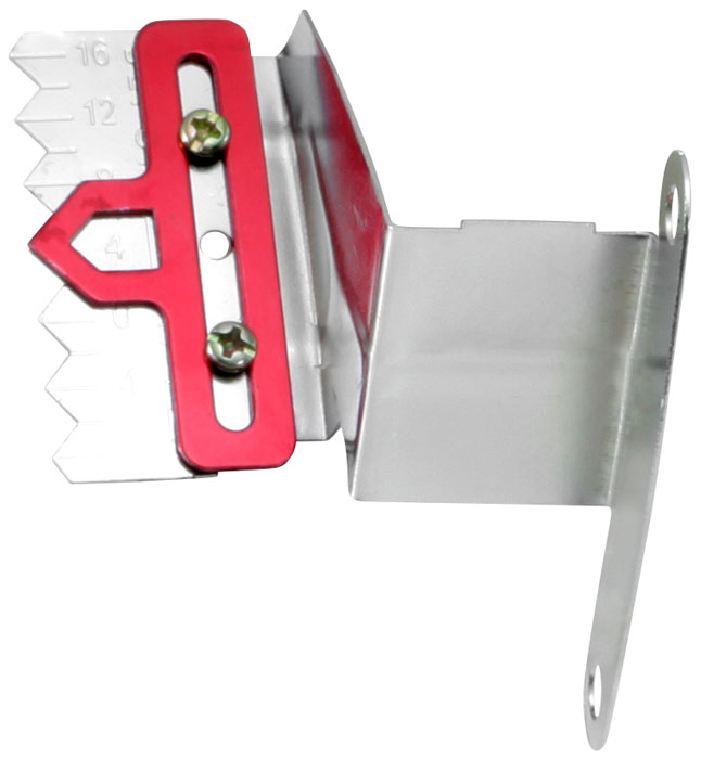

Re: Timing Gear and Cover
you can even use the really cheap pointers like this one ive used them and just set the red pointer to set as my zero or top dead center ive never found one where the zero is perfect on a non adjustable one my self there close but not perfect
Looking at that color and knowing that orange would not be 'correct' I think I will go for the always nice black block with grey heads. Will have some thought about it.
That marker is really cool. Will try to find one.
