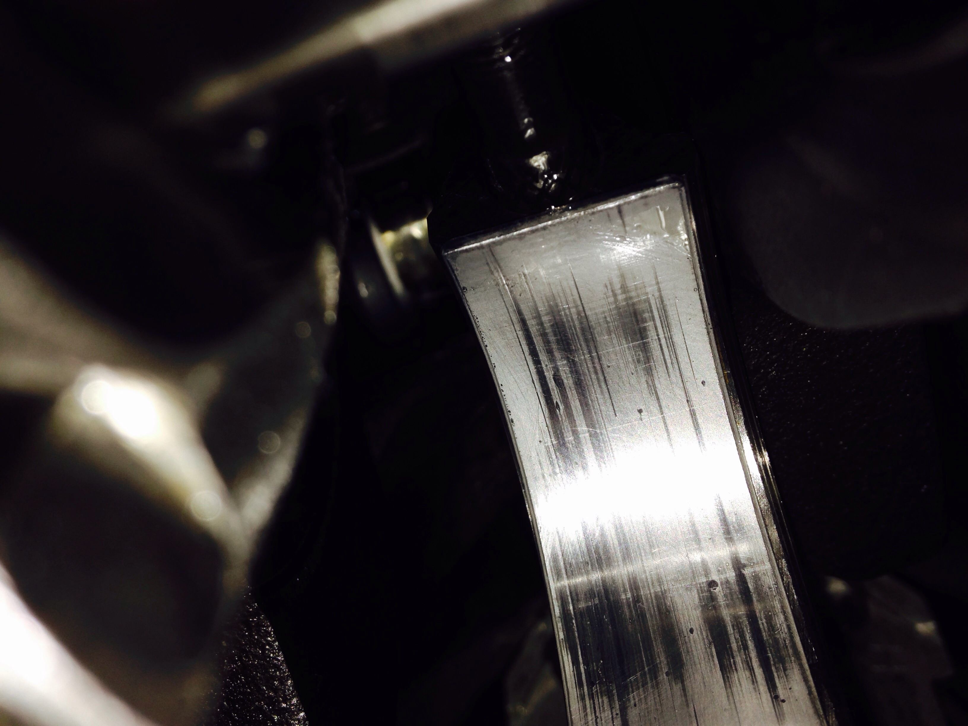

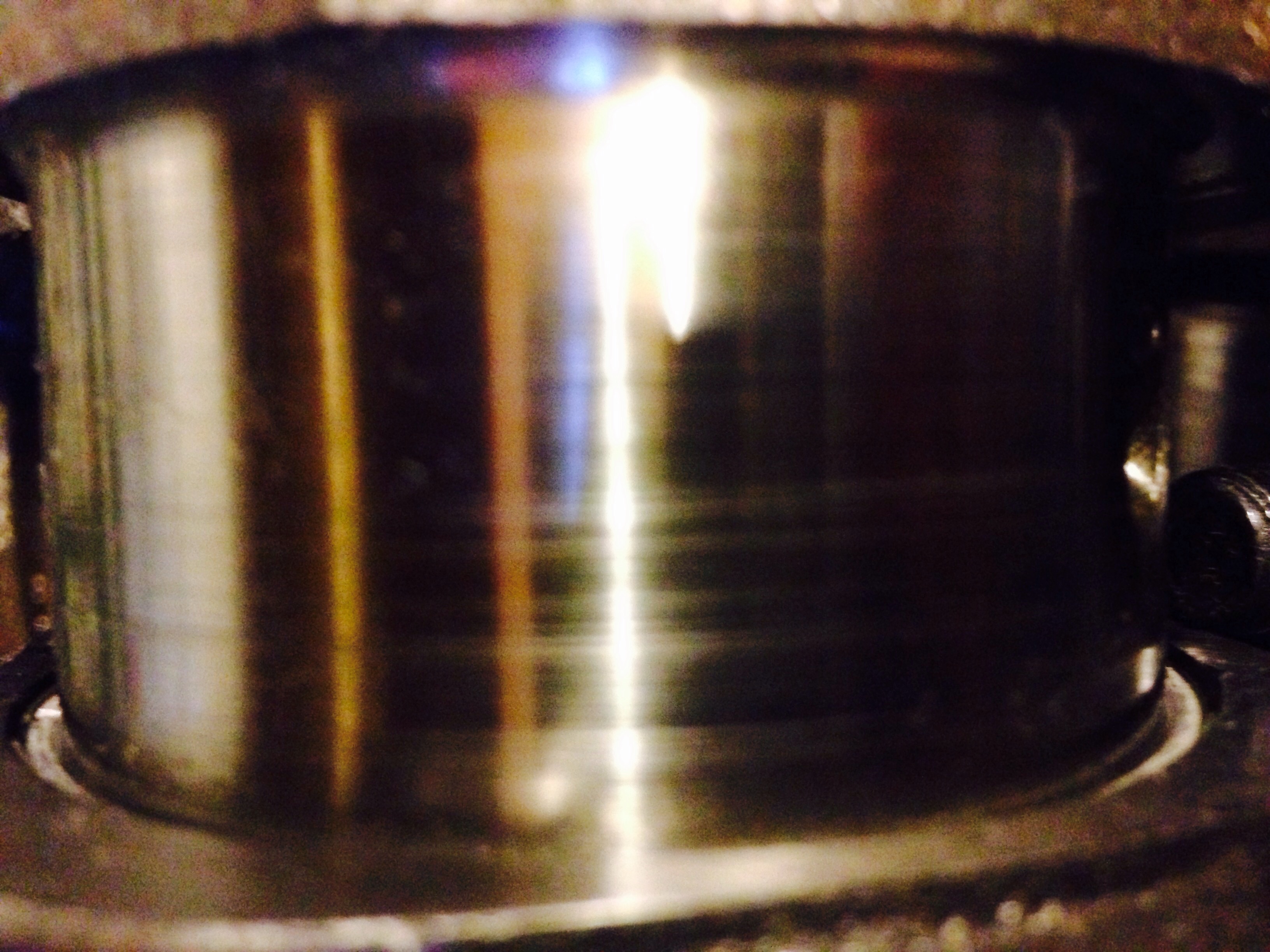

Use some plasti gage on it or is it scored enough to be junk.
Put a crank kit in it. Really don't want to send it out cause it will set me back a while on getting the car on the road
Next question is since the nuts were loose, will the studs on that particular rod need replaced from possibly being stretched?

Re: Loose rod cap
Crank kit is the quickest way to fix this correctly. I'd replace the connecting rod bolts and nuts.
Would something like this tend to make the connecting rod bearing bore egg-shaped?

Re: Loose rod cap
doesnt look to have been run very long like that. i'd put new bearings in it, and some break-in oil. run it and see what happens. in the meantime you can always save money.

Re: Loose rod cap
Not good...
There's no telling "why" that happened, or what it might have damaged, beyond what you can see. Might be just yerbasic cheeeeeeeeeeeeeep rebuild and somebody forgot to tighten that one; might have been abused (over-revved for example) and did that; might be that after it got loose the bolts got bent or the cap distorted or the mating surfaces damaged; just really hard to say.
Sure, you "can" just slap it back together and hope for the best; maybe it'll work out; however, that's about the best plan I know of for assuring yourself of the need to pull it back out in acoupla hundred miles because it failed again. Me personally, if anything I have ever done required luck on my side for it to work out in my favor, I've been hosed, every time without fail. I sure wouldn't take the risk.
As Paulo said, a crank kit (crank & bearings)... but also a rod. Which requires removing that piston from the block.
It's too late now for advice on buying a motor; but that would have been, had you asked, don't buy a motor with a bottom end noise and just expect you're gonna be able to use it anyway without substantial work and expense. You'd have come out cheeeeeeeper in the end paying more for a known good motor than buying a cheeeeeeeeep trashed one and having to fix it, even if you got it for free.
