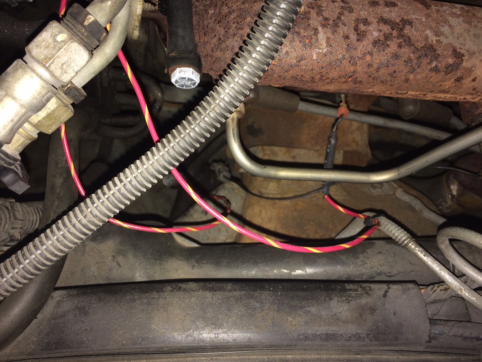

OK so here's another question. Still tracking down the same problem. The guy put a set of aftermarket gauges (pillar gauges) from Summit on the car. Tracing wires, I find new wired attached to what I think is the temp sensor? There are two wires. One attaches to the drivers side, just below the exhaust manifold toward the front of the motor. The other wire connects to a factory wire that runs under the car. Both are routed up and over the motor to the passenger side, toward the rear of the motor and to some sort of switch or sensor on the block on the passenger side, below the exhaust manifold. Is there a temp sensor on both sides of the car?? I can't get my head in to position from above or below the car to see what the passenger side switch or sensor is. Sorry to be vague but I can't find what these two switches or sensors would be. No idea if it has anything to do with my problem but I'm tracing everything.
