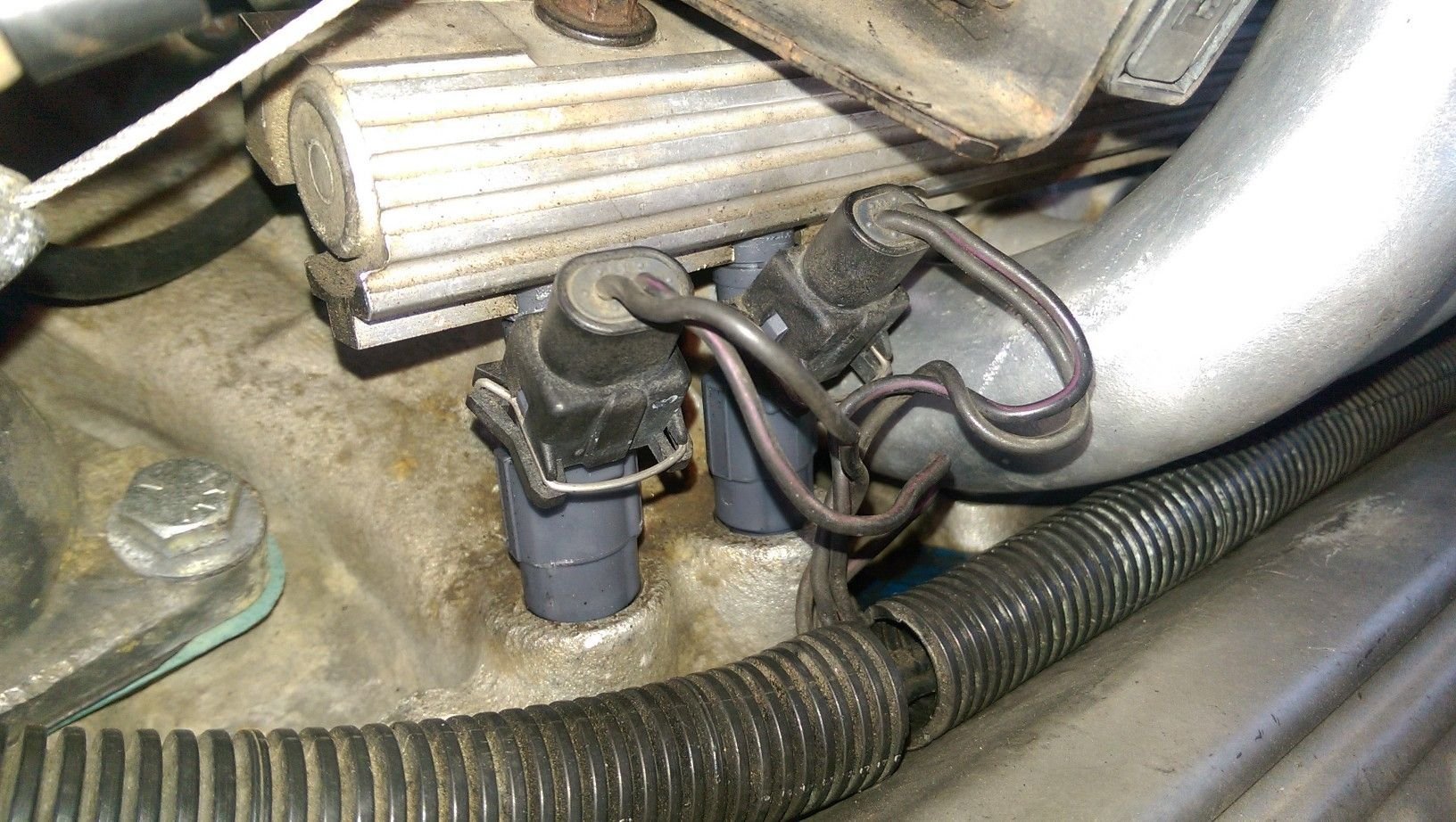

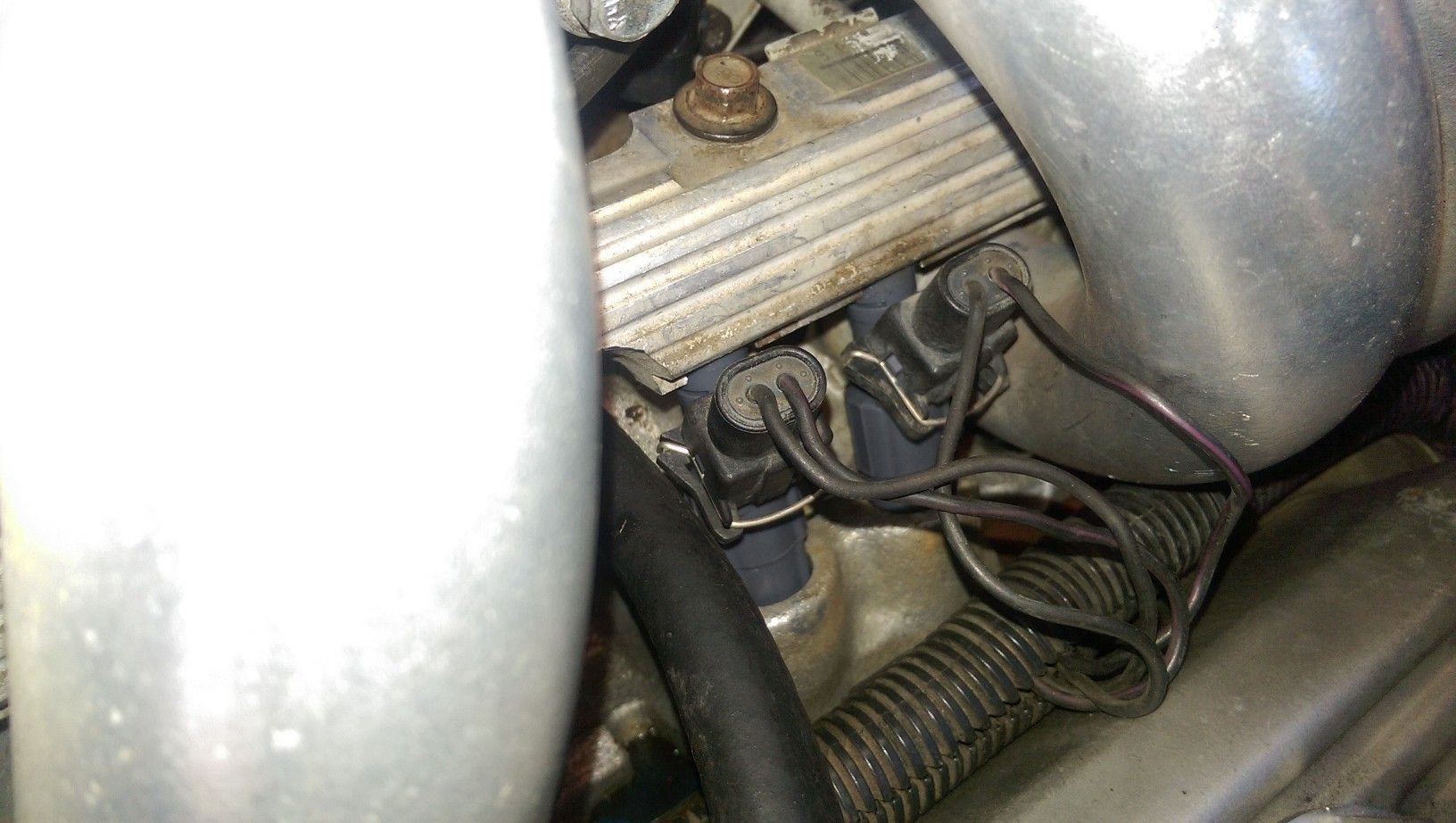

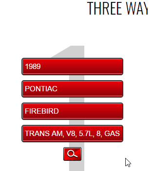

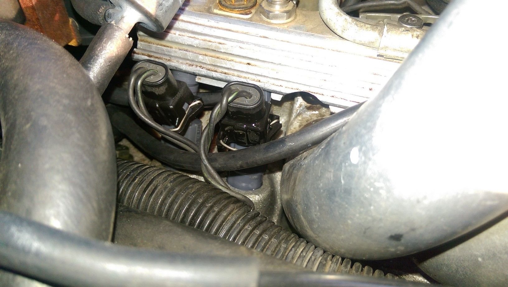

So at the advice of one of the places I take my 89 GTA to, I bought these fuel injectors.
They were put in, and seemed ok for a while, but I started getting some smoke from the engine on initial start and took it to get looked at to a different place.
They said that these injectors don't fit right, that there is some clip system that normally keeps them in place, but my car doesn't have. I have also included pictures of the injectors in the car and you can see how they are in numerous vertical positions up and down.
After trying to adjust one as I was directed I now have gas spewing all over my engine when I go to start the car.
What I would like to know is, who screwed up here, my garage(s) or five0motorsport.com for listing them as fitting my car as an "upgrade" or am I just missing a needed adapter or clip that will make them fit properly. Or is it on me for not knowing better?

If your car is an 89 trans am and you have a stock intake they are not going to be plug and play. They are going to spew fuel all over because they are bosch lll's and they are too short. They will fit an LS1 but not a stock set up for an 89 gta. You don't need a "clip system" either. Give us a call and we'll tell you what to do to fix it. They are either going to need our adapter on the bottom or you can just add another oring.

Another eeeeeeeeezy fix is to just grind/wizz-wheel a bit off the little boss thing the fuel rail sits down on. 1/8" or just a bit more will do it. If you ever decide to put the longer stockers back in, just stack up a few washers on there.
The clips really do help... theoretically once the thing is put together they aren't needed at all; but they REALLY DO help out during assembly, keeping the whole thing from falling apart while you worm it in there. They just make life that much eeeeeezier. You can pick em up off of about ANY vehicle(s) at yer local buzzard nest.

I didn't miss the clips. No modern cars have them really. Everything is held in by rail pressure now. The Southbay Bosch III's have adaptors on them to extend them to fit the TPI rails. No issues with anything falling out during assembly. The o-rings hold them in place just fine.

Listen,,, all you need is another oring on the bottom of the injector to make it the correct height. You can do this. Look at the bottom of the injector. There should be a plastic piece that is holding the oring ring in place. Right above that oring there's a groove. Just put another oring in that groove. Install into the intake and make sure that the second oring sits on the outside of the intake. It just acts as a spacer and will give you the exact height that you need. Lubricate the upper orings with some liquid dish soap and lower down the rail....your leak will stop. Don't let someone else charge you an arm and a leg for a simple fix. Other option...send the injectors to us...we'll apply our adapters to the bottom...NO CHARGE! That will solve your problem as well.
