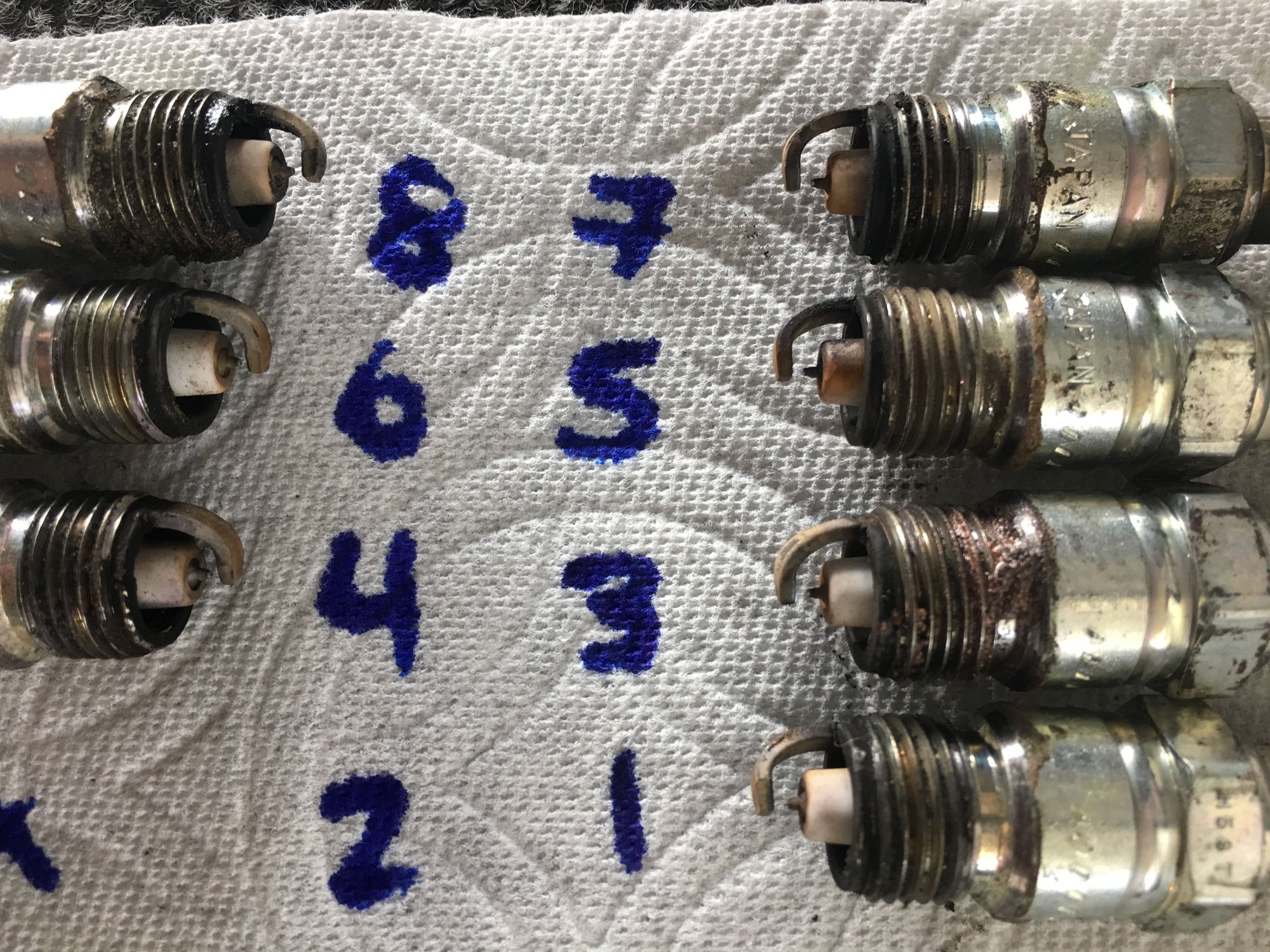

Well I replaced the 1,000 mile old NGKs with AC Delco R45TS (stock) and no difference. This engine is starting to get to me.
Here's what they looked like. Pretty OK. Interesting though that the gap had grown from the .035 to almost .039. And I am really careful when I gap so something grew that gap. Plug two had been removed, grit blasted and resinstalled the other day since it was heavily oil fouled.

I am no mechanic by any means but those plugs look like they have a heck of alot more than 1000 miles on them. The ceramic looks good but there is an awful amount of black soot on the end of the plugs. Running a little rich maybe?
